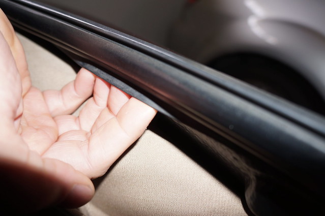

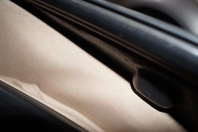

Finally got around to getting my rear top trim correct. I noticed after I replaced the top that I would get a few water droplets in the trunk after washing her. After researching and seeing how mine was I figured out that I hadn't pulled the rubber on the rear trim over the rain rail. So today I pulled the rear carpet out, removed the retainers and then from the outside pulled the rubber flap over the rain rail. Then it was just a matter of putting it all back together. There wasn't really enough room for me to get a picture, if you are changing a top then take a look at the black trim around where the top attaches and you will see what I am talking about.

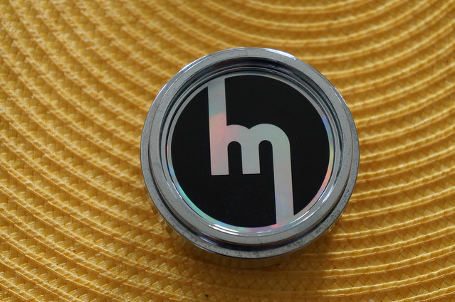

Managed to get a datalog with the CEL in place, sent that off for review. Saturday I went to storage and put the aluminum valve stems on the new Flatouts, also brought the center caps home. I put my usual stickers in place:
This time the guy I get them from used holographic chrome (he also sent me some normal chrome ones), I decided to use those to give the center of the wheels a little snap. Yes, I know I need to do some more cleaning of the caps. One of the caps has a little ding in it, unfortunately they are NLA from Konig so I'll have to live with it.
Got our good camera charged up and was able to get some pictures of the rain rail and rubber trim I was talking about before. In the first picture you can see the rain rail in the background (the textured piece) and the trim at the top. In the second picture I'm pulling the rubber piece attached to the trim out so it can be seen, this is what you want over the top of the rain rail.

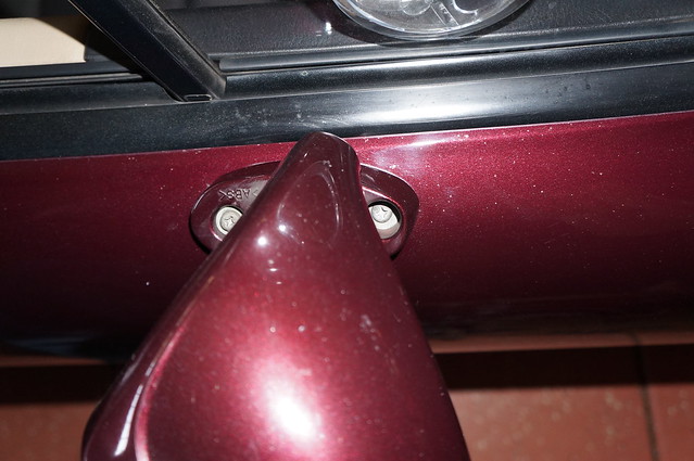

I had noticed the passenger mirror seemed to be moving a bit, when I washed her a couple of days ago I checked and it was loose. After I pulled the door card and moisture barrier plastic off, I discovered all that needed to be done was to move the mirror and tighten the two screws from the top. This is for an NB, I can't say if the other generations are the same or not.

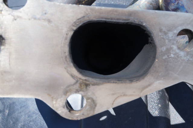

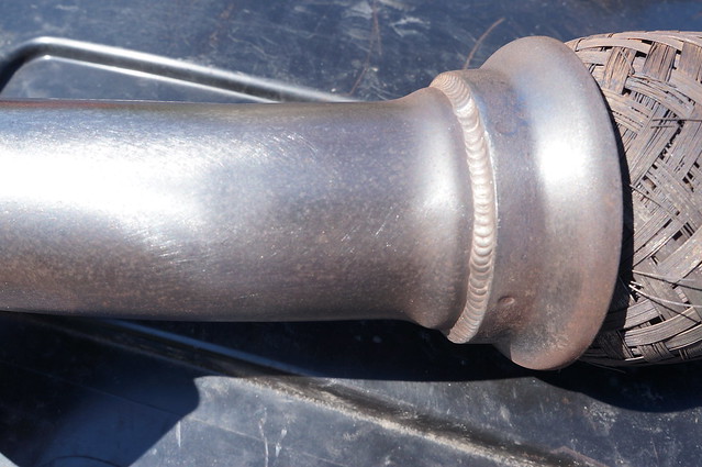

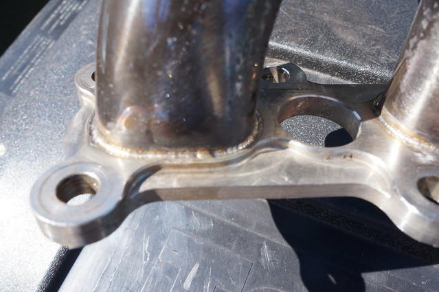

Decided to get started swapping out headers, the day was nice without getting too humid so it's all done. I took a few pictures of the MS header showing the nice welds (excuse the out of focus, I took them in bright sunlight so apparently the camera didn't quite focus in well).
Inside runner:
Outside runner:
Flex joint weld:

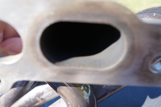

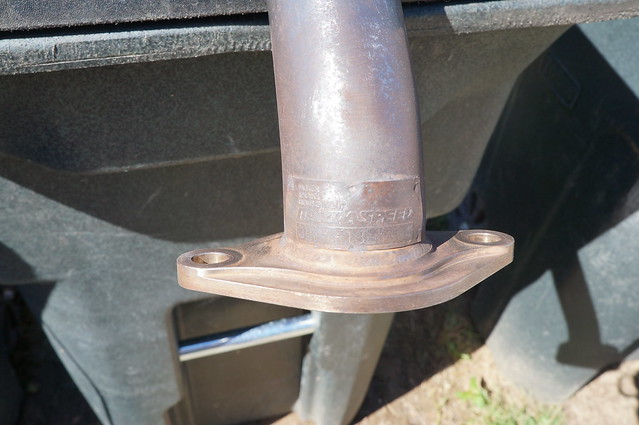

Once I had the Cobalt off I took the same shots (well not of the flex joint since it doesn't have one).
Inside runner:
Outside runner:
https://c1.staticflickr.com/8/7400/27866450392_a4143ce6dc_z.jpg
You can see the welds are a little finer on the MS. It doesn't really show in the inside runner pictures, but the MS seems to be smoother there.

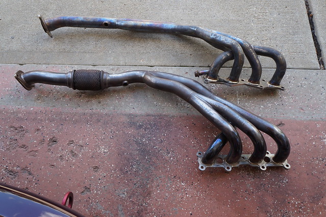

Here are some side by side shots for comparison:
[img]https://c1.staticflickr.com/8/7342/27866418952_6341fd9602_z.jpg
As you can see the section on the MS where it goes down to two pipes is shorter than the Cobalt uses. That proves the Cobalt isn't a copy of the MS (in case anyone wondered).

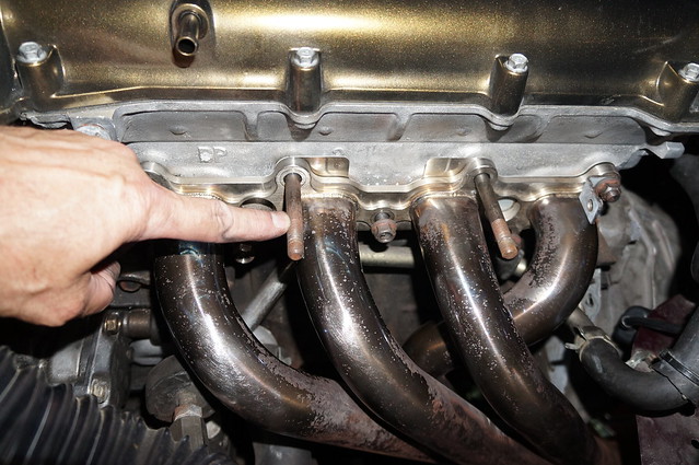

I didn't document the removal/installation of everything because it's all been done before. One thing of note, if you have a supercharger the three front upper studs are replaced with extended studs as that is where the mounting bracket for the 'charger is attached. If you want to save yourself a lot of aggravation remove those three studs. The header slips right out when you do.
