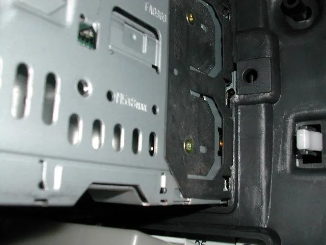

All was going well, I'd taken off the plates that cover the holes on the front of the HU, inserted the removal tools into the appropriate holes and the HU didn't budge an inch. So I had a look up under the dash and found 2 screws that I think have screwed the actual clips into the HU. Here is a pic from under the driver's side dash. More pics can be found at http://au.photos.yahoo.com/bc/zed_hsu/lst?.dir=/Mazda+HU&.view=t
So do those 2 brass screws in the pics need to be removed? Do the P5s in America have those same screws holding the clips onto the HU? Coz they're in a real difficult spot to reach and undo, especially on the right side of the HU.

Yes, the Proteges in America have the exact same setup. The screws in the picture do not need to be removed. You will notice that the bracket acts as a large spring clip holding the head unit in. When you insert the removal tool, it will push the spring clip in and allow you to remove the head unit. When I took mine out, I just grabbed it by the tape deck as I pulled. The faceplate of the tape deck just pops off and you can grab hold of something solid. If you don't have the tape deck this wouldn't apply.
