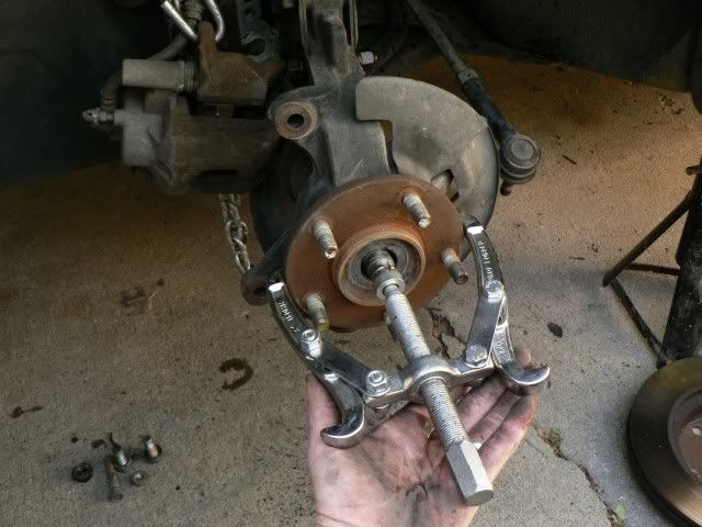

The gear puller may still help him though.

Definitely use a pusher/puller. You can "rent" them from autozone (not sure if the have that in Canada)...I have had to use one every time I have done a bearing. Just a heads up, when I got my rear hub off, the inner race of the bearing stayed on the spindle and greasy bearings rolled everywhere. We had to heat and work the inner race off.

The rears are cake with the proper bearing puller like mentioned...you won't need heat, or anything...they'll pop right off...just remember you can't reinstall anything without a new bearing to press in...for the rears, just a dead blow hammer and a block of wood or something to evenly distribute the load...and it'll move right onto the stub axle...
the fronts suck because of that little clip that is hard to get to...and because there is no fixed stub axle to push/pull off of...which is why the only 'easy' way to do it is with a press...

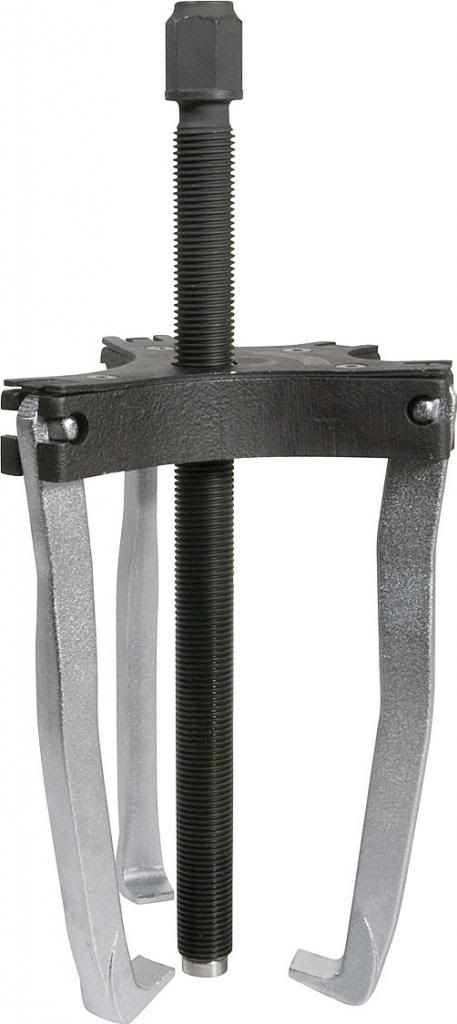

The one I have is a cheapo too. You can tell just by looking at it. The better ones are hardened steel with a tonnage rating. (that's not my pic but it looks like the kind that would break too)
I'm pretty sure the "loan a tool" programs have good quality pullers or they would all come back broken.
This one's rated 7 tonnes:
so i have an update! i went out and got the puller, i cant believe how amazing that thing actually works, nothing budged it and it just pulled the bearing right off,
although i have a new question, i the inside raceway of the bearing suppose to come off the hub assembly, does this mean i have a defective bearing or am i suppose to press it in,
Are you talking about the new hub ???
I thought the hub assembly was all one piece and it just slides onto the axle stub after the old hub (and the old inner race that remained stuck to the axle stub) has been removed ???
I had the same thing happen...the inner race stuck to the spindle. Just heat it up and you should be able to work it off.
