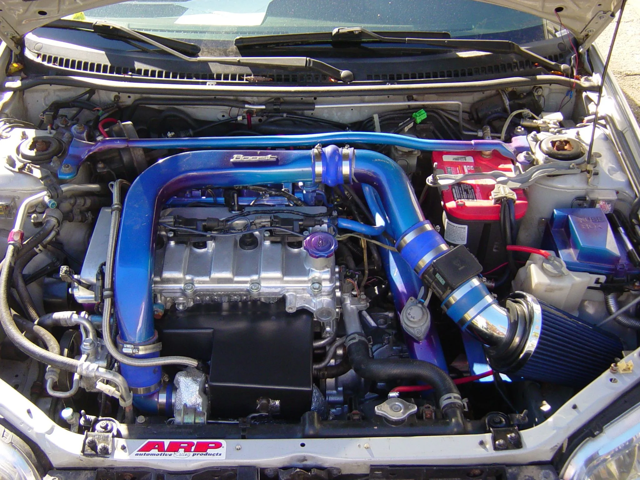

hey guys,
this seems like the proper place for this question since i am having the same problem. I rebuilt my 02 mp5 motor for the third time with ALL the goodies (removed vics and vtcs, ported, by passed throttle body coolant line, etc.) I start my car and it idles soooo sweet until it warms up and then dies. While the car is warming up, if I just barely touch the gas, it dies. There was one time that I was able to get it to rev up to about 3,000, but as soon as it came down, yup! IT DIED. When its warmed up and I can get it to start, it wants to idle very low and just quit. Now, all the sensors have 93K miles on them. I understand that open/ closed loop has to be playing a role in this and it has sensor written all over it, but the big question is which one? Could it be my MAF is dirty? I have a universal O2 sensor, could it be hooked up wrong? Is my crank or cam sensor bad? When I blew the last motor I threw a rod and it blasted the knock sensor out of the block, could this sensor be bad and cause this problem since it controls timing too? I have done so much to find a vac leak and prevent them with clamps and ties, is there any possible way to say "YUP FOR SURE ITS ________ SENSOR!"????
The first person to remedy my problem gets a case of beer on me. If you dont drink, well then start!!! j/k

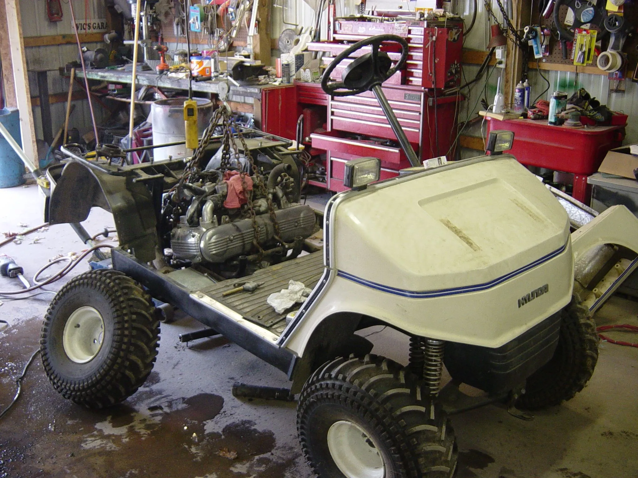

THANKS A BUNCH IN ADVANCE! I know theres a hundred more just like me out there looking for the same answers. Btw, heres the bay now. The golf cart is where the motor will end up if I dont figure this thing out soon!!!
Do you have a check engine light? It could be a lot of things, vac leaks are notorious and it could be a sensor. Idle control? Hard to say...
