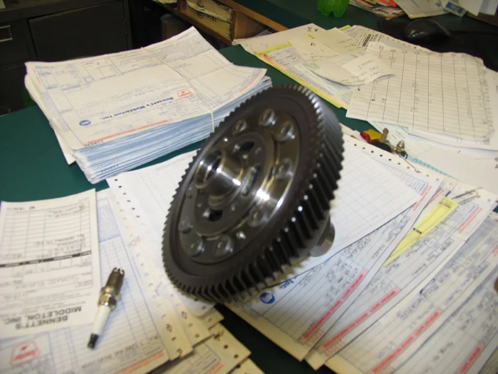

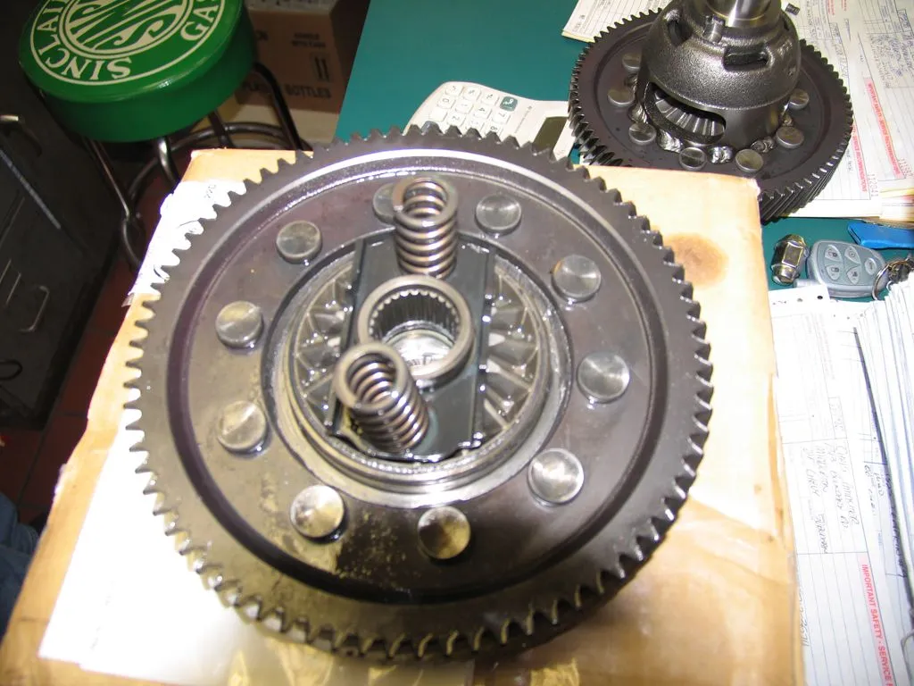

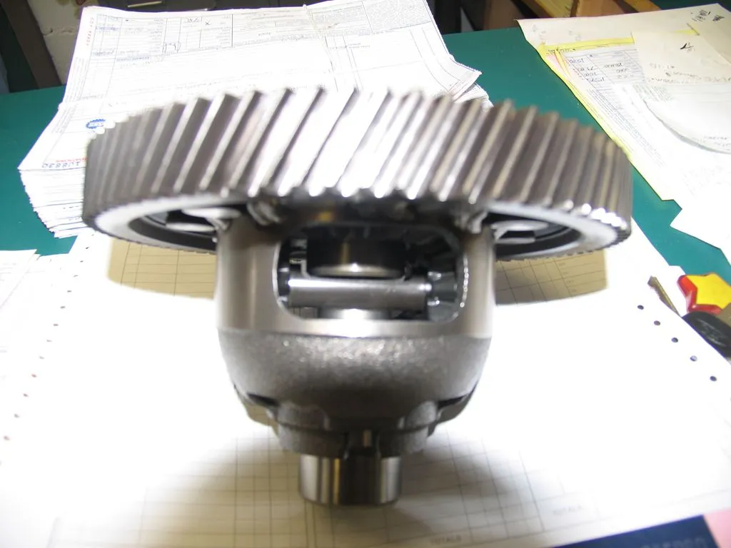

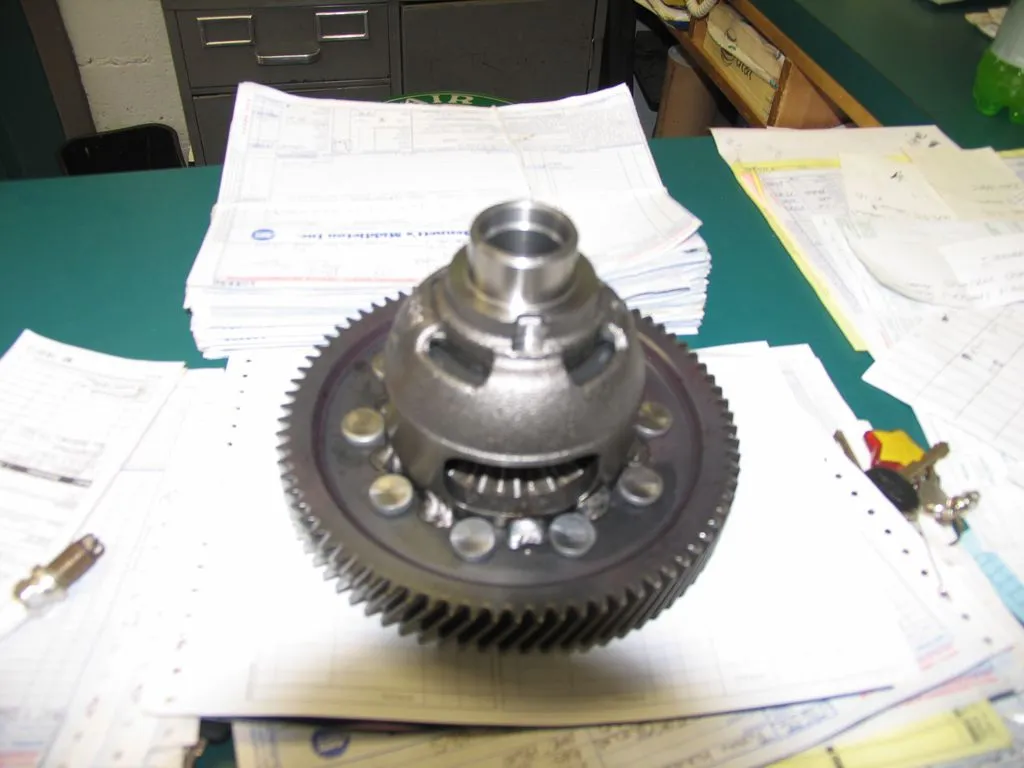

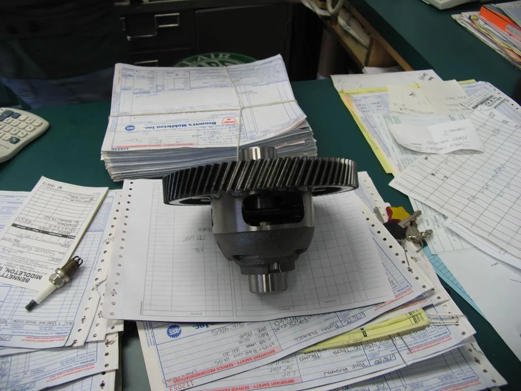

Photos of split diff compared to open one Mazda is tyring to sub
EDIT: first 4 are the open diff they shipped me, and the last photo on the far right is the stock OEM LSD I had the shop remove. There is an internal clutch mechanism on the LSD that is not present on the open diff.

tallrd said:
jpg's are all labeled so you know what is what
I don't see any labelling, and from the pictures you posted, it does not look like the standard (open) diff...
the only difference on the "new" one I can see is the welds that should have been there on the initial LSD...
