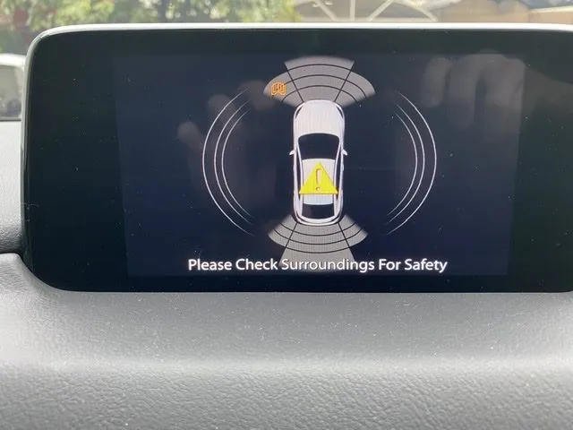

Out of the blue my Mazda CX5 is showing the following warning light on the infotaintment screen. Anyone knows what this means?
What model is it? It looks like a display for the parking sensors, and there is an obstruction at the left front of the vehicle.
It does that on mine when i have ice covering the sensor. It looks like you may be in warmer climate. You may have a dirt or deadbug on the sensor or it may be a sensor malfunction.
The yellow warning symbol indicates a system malfunction. The orange symbol looks like a manual, so it is probably referring to checking the manual. Since the symbol only appears over the front left parking sensor, I'd check to make sure the sensor isn't dirty or blocked, as youri suggested. If it's clean and unobstructed, take it to the dealer for further diagnosis/warranty repair (if available).
