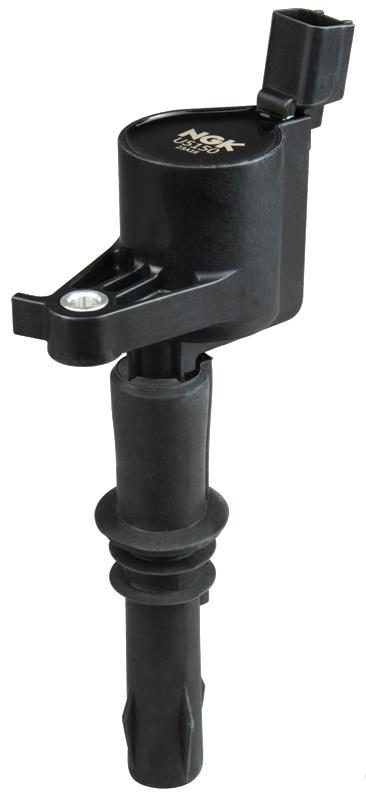

Thoughts on these? I'm looking to replace my coils as well.

If I had to guess the OEM coils are PROBABLY nippon-Denso. Most Japanese cars use denso for most of the important electronics... Look closely at the OEM ignition coil. It should say nissin or denso or hitachi or something on there. that's the OEM supplier that makes it. Mazda doesn't make ignition coils they buy them from someone else. When it comes to a lot of things... belts, bearings, motor mounts, etc. I live by the "cheapest I can get" philosophy. It may wear faster but if I can buy 3 or 4 aftermarket motor mounts for the price of 1 OEM one, and they only take 20 minutes to change, no big deal when they tear. However, when it comes to electronics like ignition coils, sensors, and engine controls stuff I will only buy OEM parts. Most Japanese cars don't play nicely with aftermarket sensors and coils. Lessons learned over the years of working at a dealership. A cheap part can have you chasing your tail with driveability problems especially if you replace a bunch of stuff at the same time.
