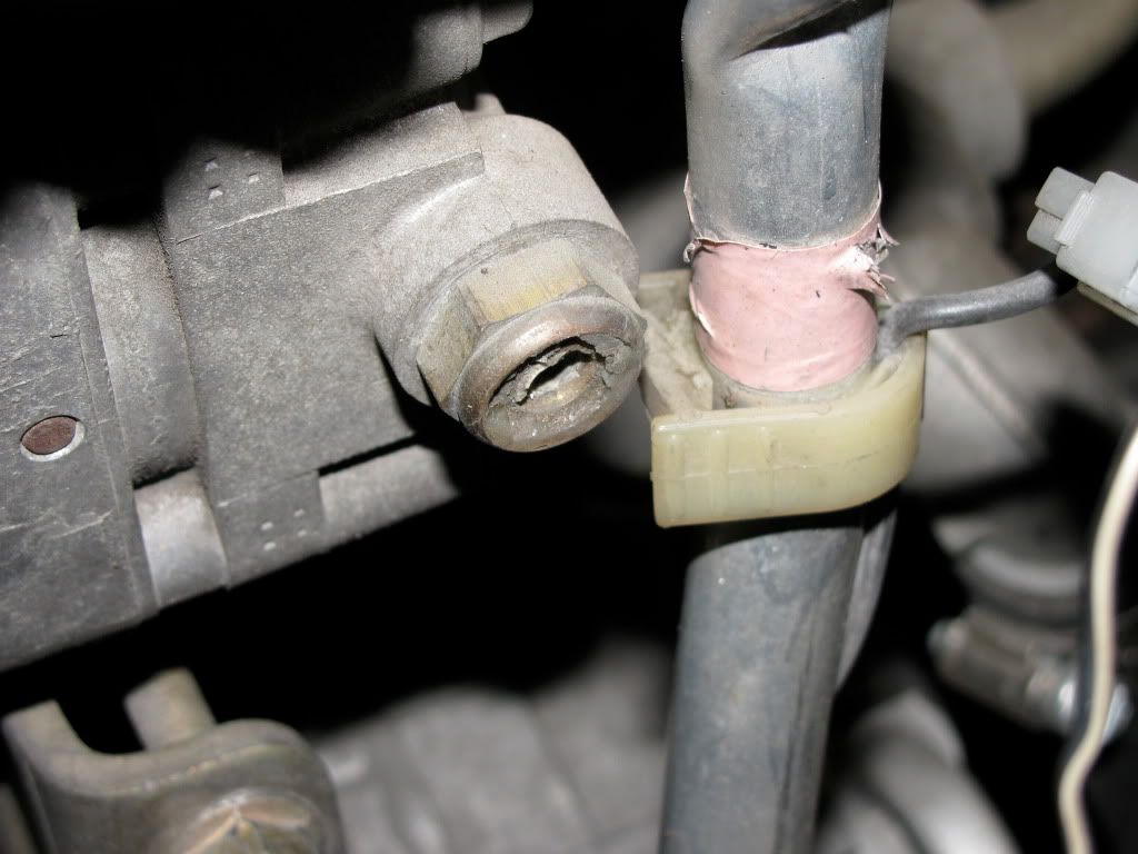

Is this the culprit?
And is the above wire the one that needs to be connected to that point? I've been trying to find the actual part itself but have not found it yet. I do think though that I could probably find a junker and take it from there. Let me know if that's the one I need. Thanks for all the help guys!! (thumb)
good job. i actually think i might have one of those sitting around.. want me to check?
