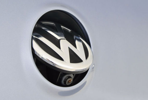

These backup cameras should all be done in the same way that VW did with the CC (under the logo, witch flips open ONLY when backing up... thus always staying clean)... Brilliant!!

Yeah, I know Hyundai did this for the hatchback Elantra model. I must've toyed around with just that one feature for like 15minutes while my friend was working a deal for his Santa Fe lol.
The trouble is, this being VW, the mechanism that actuates that flip is no doubt grossly over-engineered, will fail at 30,000 miles, and cost $1200 to repair (since you'll have to replace the "backup servo actuation module", and that will require dropping the engine).
the fact that it will break down or not is not really my point.
i am only saying that its a smart idea to keep the camera clean so when it is actually needed, it will be clear.
Right now, the way most cameras are setup (exposed), they become utterly useless in the winter, so they could also be considered broken from the factory.

I think Addabox's point was in order to keep an exterior camera clean from the elements from the outside as shown is to add complex actuators and motors that will eventually fail, probably after the warranty expires and will add to the overall operating costs of said vehicle. Could there be a simpler way of keeping the rear camera clean without complexity? And I'm curious, because my winters are mild (nonexistant to northerners (lol2)), but when you de ice your windshield and mirrors can you not de ice the camera before you start driving?

Clearly your winters are mild, because you would know that even cleaning the camera before leaving does nothing, because driving for 10 minutes or more in the winter here is enough to completely cover the camera in crap, and making it useless...
This winter I also had access to a indoor parking at work, and my own garage at home. Even when leaving home with a clean camera, once arrived, when backing up, I had to keep a paper towel and go out of the car before backing up because the indoor parking was pretty tight, and the camera was completely blocked.
So I was actually having to clean the camera before I left home and before I backed up at work. just to be able to use it.
This is why in northern places such as I live in, having a camera hidden, unless going in reverse, makes much more sense. How its actually hidden (the solution/mecanism) could be different from VW as long as it works, It could be as simple as having a shutter type cover as found in some digital cameras... It just makes no sense to me to have a camera exposed 100%of the time when its being used maybe 2% of the overall driving time during its life.

Ah, I see now. Last winter here in South Carolina got about 3-7 inches, but I didn't have a rear camera in my Honda at the time to even complain about how it was useless. I don't see how y'all do it up there!
Btw, I like your shutter idea.
