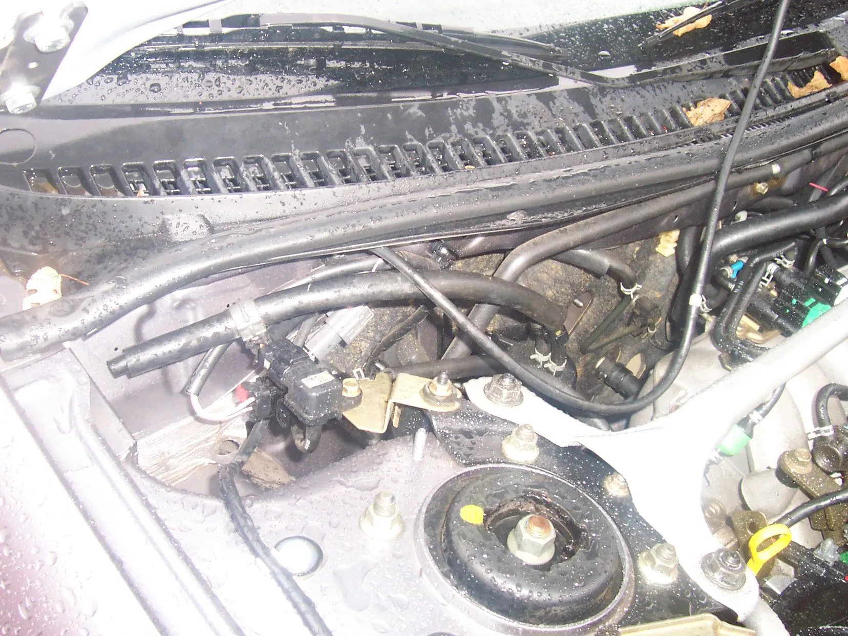

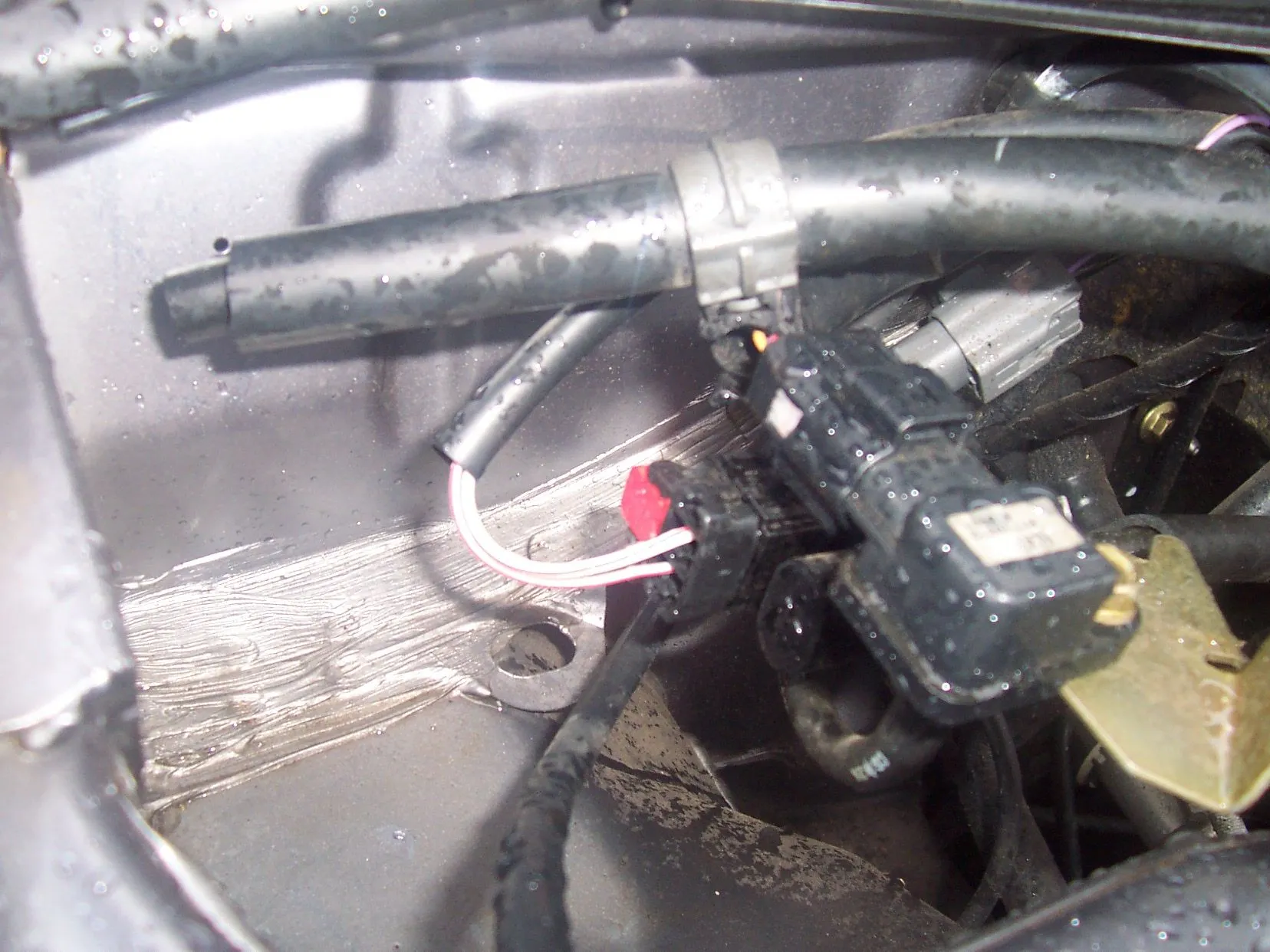

Check THIS out!! Alright, so last night I was reading in the Mazda workshop manual, page 01-16-07 to be exact, and saw that the one hose going to the IM from the purge solenoid was supposed to be going to the catch can on the other side of the engine bay. Well, I went out this morning to take a look, and this is what I found. A line from the catch can was cut, and just hanging there. Going to re-do this to make it right, maybe that will cure something at least.

Turns out they had that hose pointing the opposite direction, so I turned it the other way facing the driver's side and it connected up to the hose coming off of the sensor with no trouble at all. Apparently they just pieced things together without knowing where they went. I'm still concerned about the high idle, I haven't tried to drive it yet since hooking up that hose to the solenoid though.
I'll bet that solves 99% of the problem! Lucky!
