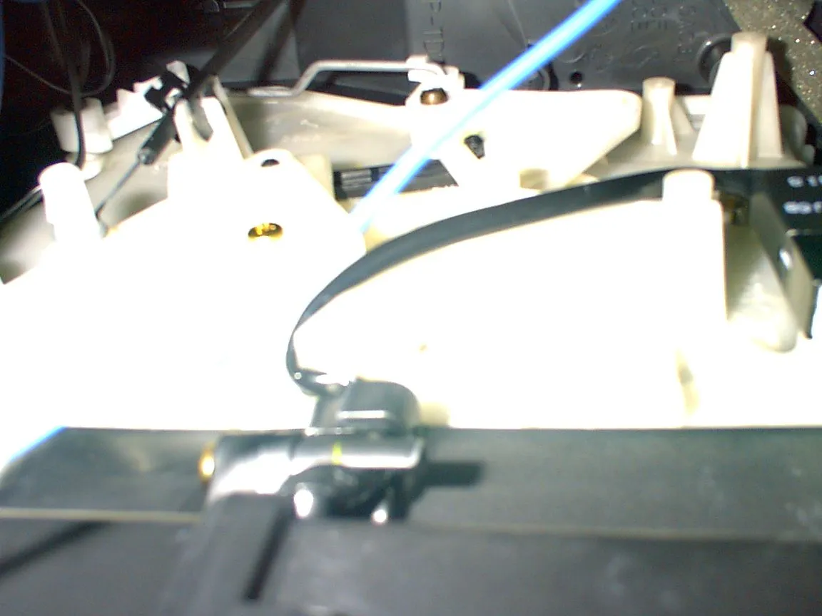

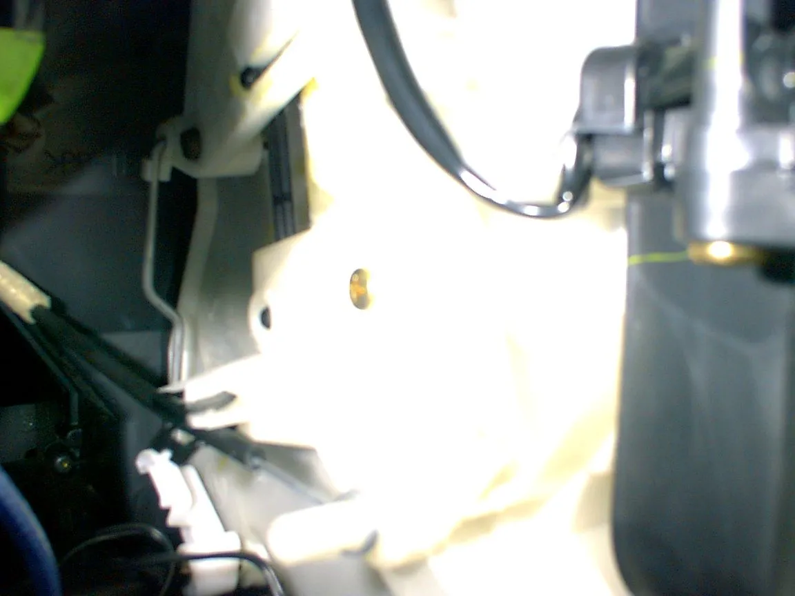

I took two pics, but honestly elemental's pics look much better. The lighting in mine suck...but here they are from the glovebox angle looking behind the dash (sorry for the blurryness and lighting...

i appreciate the effort but i cant really see what i need to see with those pics.
