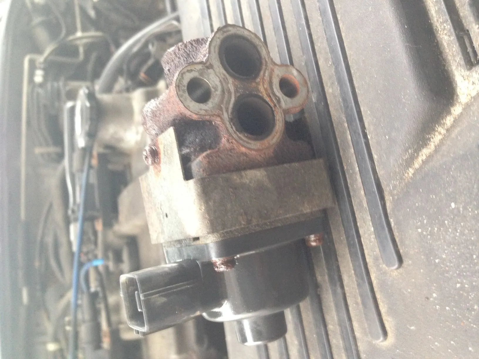

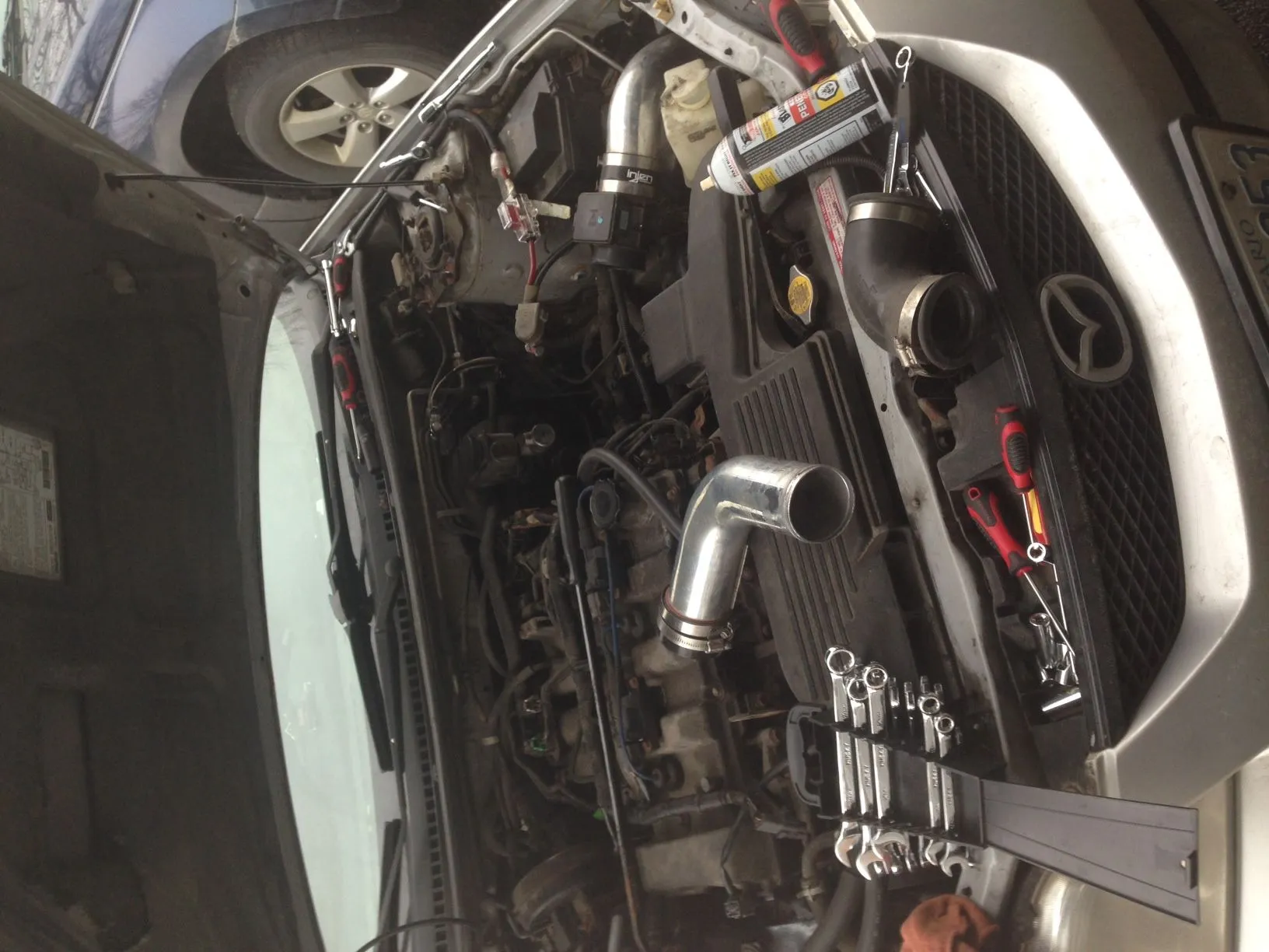

Took out my EGR to clean it, took forever thanks to a stupid metal cover over it, and the rear engine mount, no room:'(

That little metal cover thing on it turned a quick job into a struggle for room to turn wrenches etc

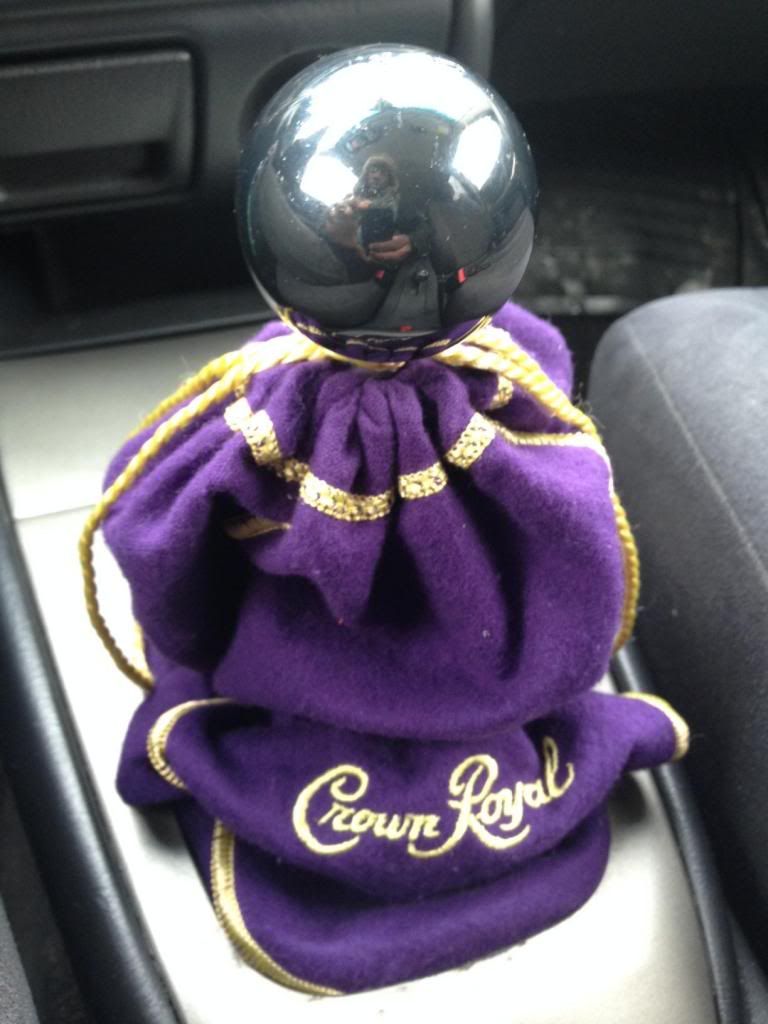

Crown Royal Shift boot mod, it took about 30 mins to do from start to finish.
1)Remove the center console to get the old boot off (2 screws at the back on either side, 2 screws in the front by the footwells on either side
2) Pull of the handbrake cover, and the cup holder part, they both just pop off (I Believe there is 2 more screws after you pop the handbrake cover I cant remember did it awhile ago)
3) Once the center console is off there are 4 screws holding the boot on 2 of them you can see the other 2 are underneath (that's why the whole console needs to come off)
4) Then cut the crown royal bag from the bottom and stretch and cut as needed till it fits over the bracket for the old boot
5) Make some cuts in the bag to secure the new boot (the cuts are the same as on the old boot)
6) Glue down any excess boot material, as this will probably lift as you shift
7) reassemble the boot and console and enjoy :)
