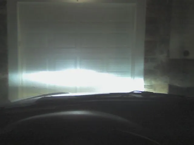

They have a sharper cutoff, but nothing other than that is "better". Dual filament high/low beam designs suck for the most part. It's not like the P5 cutoff is bad, the sedan headlights just have a very sharp one. Familias with HIDs came with the P5 headlight housing style, so I'm guessing with some modification to the cap thing that sits in front of the bulb you could get a nice sharp cutoff.

my cut off. the car is pointed to the right, which is why it looks like it slants down

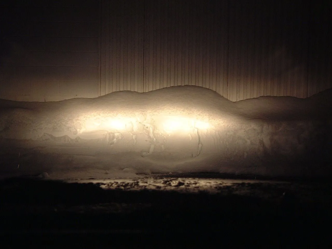

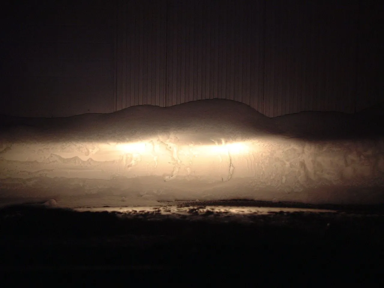

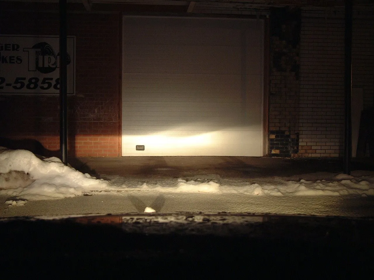

for COMPARISON purposes, here are pictures of my sedan headlight pattern.
#1 - low beams, about 20ft away from the garage door. this picture really shows how good the cut-off is on the sedan lights. it also shows really good how the beam pattern throws to the right to light up road signs and such.
#2 - low beams about 15ft from a snow bank.
#3 - high beams, same distance as the picture listed above. these two pictures show the light housings ability to provide a good pattern for both high and low beams.

the only thing I don't really like about the H4 bulb light pattern in the sedan headlights is how focused a majority of the light is.
thats a good thing when you're going down a dark road, and if you don't want to blind the guy coming at you. when i'm driving downa side road that has no street lights, i can see the beam cut-off out ahead of me on the road, and not much beyond that. then, when i hit the high beams, its like daylight out there, and the majority of the light goes down the road right where you want it.
