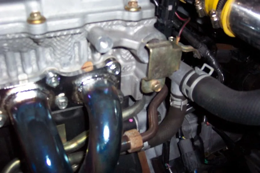

I got my header today, everything else went perfectly, except the egr tube does not allign with the mount on the header itself. Its about a 1\2" off, I tried to bend it but that didnt work out, and im scared to put a kink in the copper\bronze whatever it is, tube. Anyone else have this issue?

Holy crap, I just saw your picture. Mine was not that bad off. Looks like some tubing is broken, and the EGR tube is bent up pretty bad. I just ran out and took a pic of my EGR for reference.

actually the part where it looks broken is just a bolt head... yeah it is bent up alittle bit, lol nice attic btw, I like the insulation, reminds me of ummmm cotton candy...

That bolt sure is an optical illusion. I had to look at it for a bit to see that it was not busted off. That tube is kinked to s***.
Oh, if you have not noticed, I put up the correct pic.
yeah, I did, im too strong for my own good. im thinkin about cutting it, and welding an extension onto it. it was REALLY far off. I tried doing it that way raider, I couldnt even get it lined up it was so far off, thats when I screwed up and bent it. my obx header actually has a badge on it....is that the older one or somthing? Im taking a few min break so i dont get pissed and break shyt, I hate having a temper...specially when working on my car...
Bend the tube back. Slide the nut back and use a closed end wrench to gently bent it back into shape. You can use channel locks on the kinked part to get it a bit more rounded.
