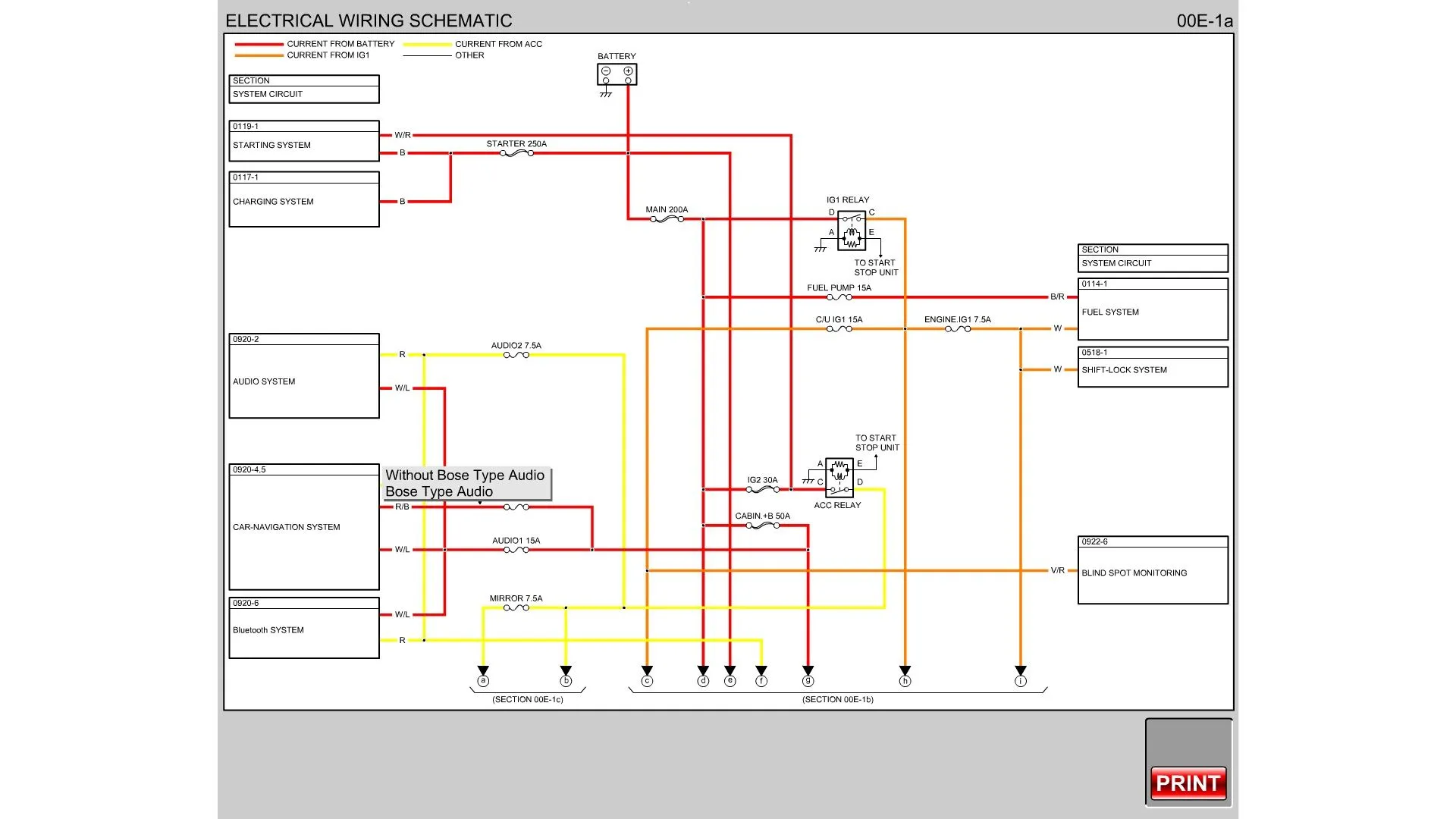

I've replaced the main fuse block which was blown, but im getting tcm communication error, and when i go to turn over the engine im hearing a clicking coming from the transmission. Did i manage to fry my tcm?
Are you sure that clicking noise isn't the starter? The line that's going to the main fuse, the 200 Amp one I'm guessing, also goes to a 250 Amp fuse to the starter and charging circuits.
But if you did get the polarities crossed them you piped a few hundred amps through the ground side which isn't protected with fuses. Probably blew out a few control module units if you did, I'm guessing.
