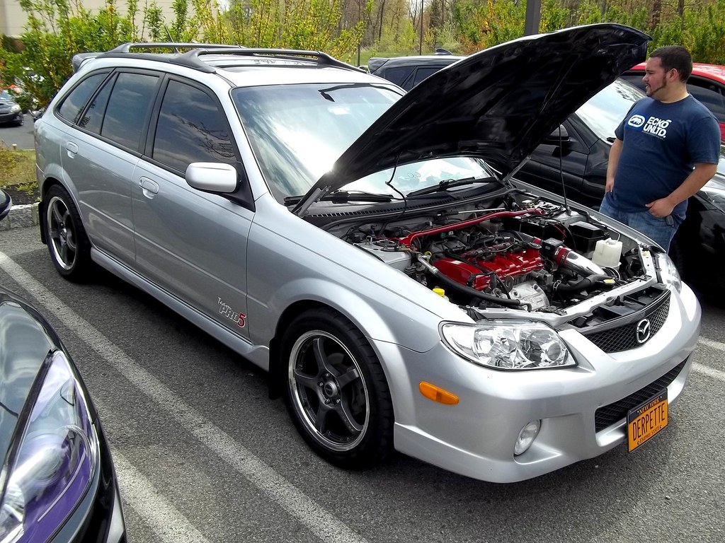

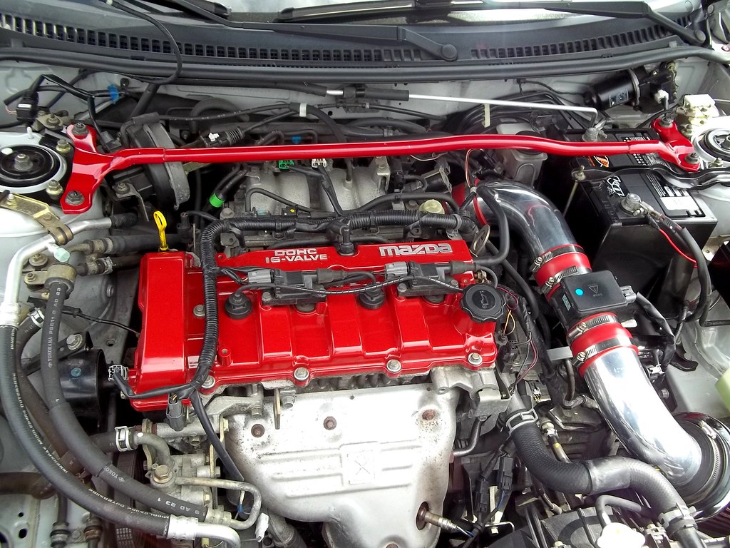

Wheelman...thanks! I had just cleaned it up the night before...here's my secret...ok ready?
Orange peelz bike degreaser
I was searching my garage and came across this...figured if it's good enough for gears on a bike it should get rid of all the junk under there. Diluted with water and scrubbed with a cloth. Then I used a hairspray bottle with regular water and went over it with a dry microfiber to make sure nothing was going to be just sitting residue. Cleaned up really well...but to me it's still dirty! Haha

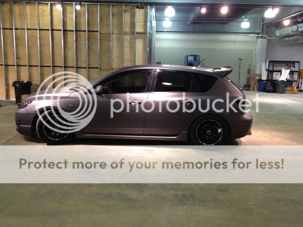

This is the last time I had fishbowl status
Ended up staying till 1130 Sunday night to help storm and the installer finish wrapping his car. Came out awesome.
Playing with the extra vinyl. Wrapped my case (badly lol)
