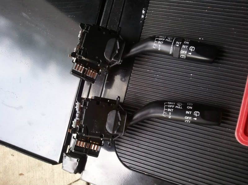

Have you grown annoyed with the single speed intermittent setting on your wipers yet, Larry? lol
If so, I picked up another MPV wiper switch at the junk yard yesterday. I was going to throw it up on the forums, but I always catch myself asking if Larry would like something before I sell it now. haha $10 if you do. :)
That is an awesome idea, what years MPV work?
I believe it's like, 2000 or 2001 to 2004 or something. Early 2000's Ford Escapes also have the same switch.
It's a very simple job. To get the steering column cover(s) off, look up at the bottom cover and you'll find 3 phillips screws. Take those out, and pry the upper apart from the bottom, like a clam shell, and they'll come off. Then it's just 2 phillips screws that hold the switch itself in....take 'em out, unplug the old switch, plug in the new switch, and do everything in reverse. :)

if someone find another wiper switch and wants to sell it lmk i want to upgrade too :) pm me if so
