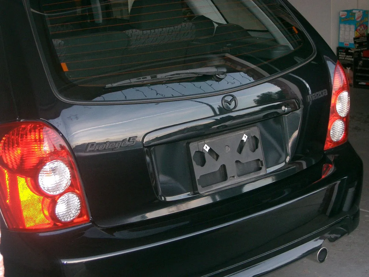

tonkabui - Do you have any pics of the painted emblems on the car?
Thanks.
If you search I've got pics of my emblems painted a metallic graphite.
