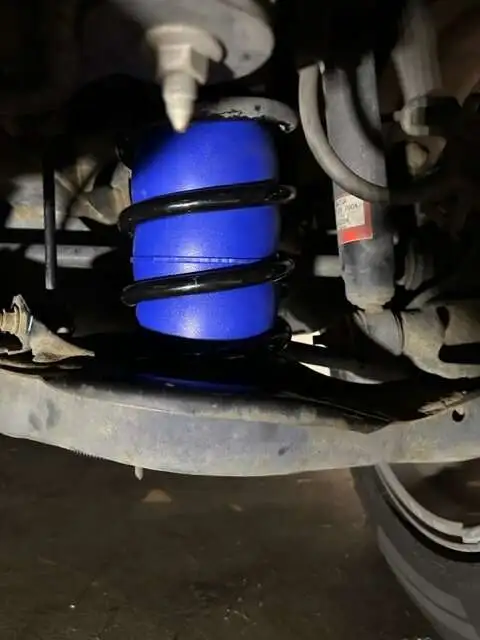

Added Firestone bags this morning. I don't normally get too much squat with a trailer but plan to carry my Moonbike on there by itself so wanted to ensure that didn't make for unnecessary squat during the winter. I bought them 8 years ago and finally installed them today. I found them easier to push through the coils not-compressed ..unlike the instructions which suggest compression is easier.
I don't know if kit has been updated but the old kit that works was this one
Firestone Coil-Rite Air Spring Kit # 4178
Sure feels like it tightened up the rear some. Not complaining.
