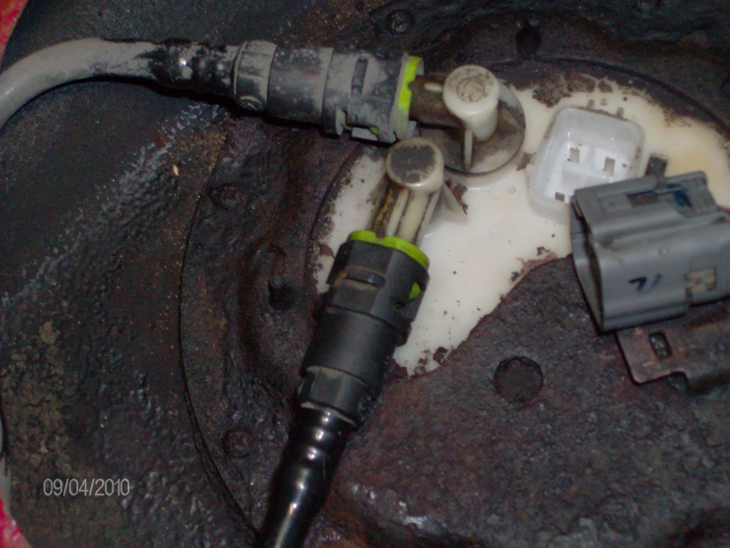

I have the same leaky situation. My problem - how does one disconnect the fuel lines? I've never seen these types of connectors before.

I was able to do it with a couple of tiny flathead screwdrivers. It was quite a pain, though. I'd recommend getting the kit if you can. The connectors are not included with the new housing so you don't want to damage them.
Thanks to both of y'all. Do I presume correctly that the function of the kit/screwdriver pair is to compress the 2 little green ears inward? Oops, never mind, I just looked at the how-to link above which described what to do, and very nicely.

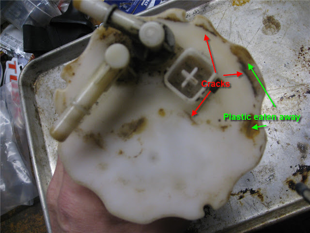

I got a car again. I like riding my motorcyle but its nice to have an alternative. It was the high pressure housing that was causing this issue. See the picture below. Several cracks and the plastic was eaten away.
Here is the info on the part I ordered from Roc Auto.
BECK/ARNLEY 0433010 (043-3010) Fuel Filter $ 30.79 $ 0.00 1 $ 30.79
its described here as a fuel filter but it is the high pressure housing.

yeah I have a theory on why these crack. I'm thinking that the coating on the plastic gets scratched by the (rusted) metal cover. It takes years, but the plastic underneath is vulnerable to attack from low levels of gas fumes or just stress cracking, maybe from slight movement under pressure. Seems every one I see that's cracked follows the pattern of scratched areas leaking.
Anyway, I'd use a new metal ring or at least clean it up and maybe paint it. I actually created a "gasket" layer between the ring and filter body. Basically just a sheet of polyethylene, like a coffee can lid. Not a big deal - should last several years even if you just put in in rusty, I'd guess.
