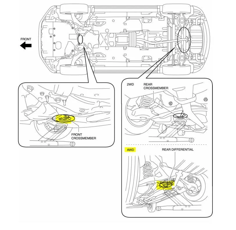

  • Jack points on the AWD CX-5 are on the front crossmember and the rear differential. The front jackpoint area is dimpled, like in the picture, and should be fairly easy to differentiate from surrounding areas. Of course, ramps would be easier to use if you have them.

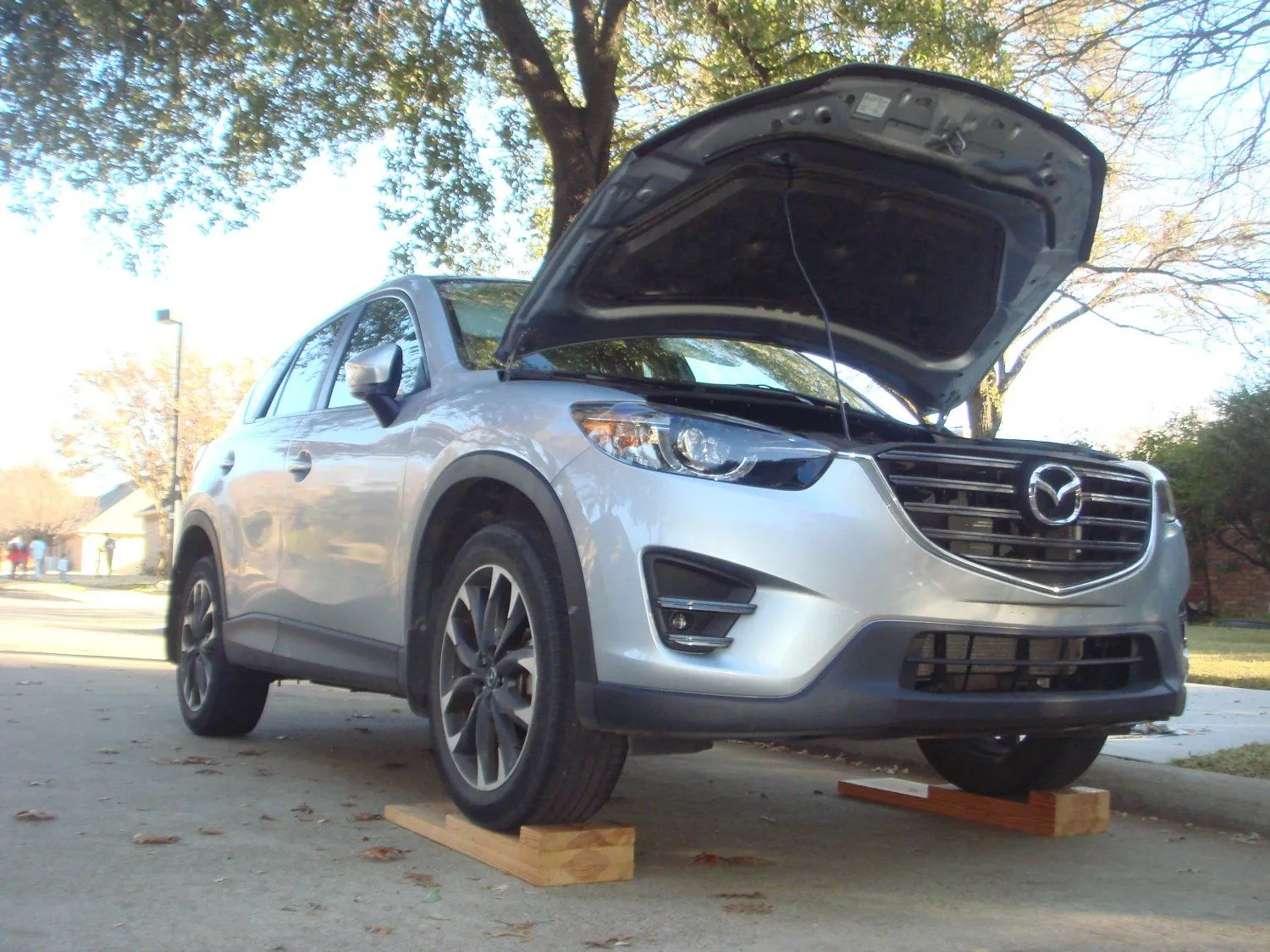

When I did the first oil change on my 2019 GTR I was glad to see you only had to remove a small access panel and not the complete under shroud as I had to on my past Mazda. I torqued the oil drain plug to 27 ft lbs.
Other tips that I do, for a funnel to drain the oil from the catch bucket back into your oil container, cut the top of a 1 gallon water bottle. Then just throw it away instead of dealing with an oily funnel. The water bottle funnel won't fit some quart containers though. I use an old spackle bucket to catch the oil, and keep a lid on it when not in use to keep leaves and bugs out. Save a pizza box when it is closer to oil changing time to use under the catch bucket and just throw it away after. You most likely will drip some oil that misses the bucket. Get a cheap mat like this if you don't want to get a creeper, to stay off the dirty floor. Can hose it off later. And take the used oil right to the auto store. I used to procrastinate and build up a bunch of used oil. Also I think a ramp is a must.
I have some of those Rhino plastic ramps. I've used them a few times but usually find the experience kind of scary. Usually one wheel pushes that ramp forward and the car is suspended on one wheel. So I just scoot under to the change the oil. I keep an old foam camping pad to lay on.
I drain the oil into a 2.5 gal water jug with a large hole cut into one side. Then I use the water spigot to pour the used oil into an empty oil jug.
I use plastic ramps for my 2018 CX-9 GT AWD, but removed the rubber pads from the bottom that are supposed to prevent them from sliding, so now the sit flush against the ground. Then I just tap them a bit under the front tires to kind of wedge them in and it goes up just fine.
Since the CX-9 sits a bit lower that most SUV's and it's chassis is more like a wagon or cross over with a long hoodline and has a quasi front chin spoiler (not really intended for downforce, but probably more asthetics and to funnel air into the inter cooler bay), I found that longer ramps work better than shorter ones to reduce the climb angle.
You can find them for performance cars with long chassis and low ride height, making it impossible to use normal ramps. My 2016 Mustang GT was so low I couldn't even get a low profile jack under it, had to drive it up on 3in high storage ramps (the ones that have rounded center to prevent flat spotting of tires) then jack it up from there, so the CX-9 is a dream comparatively!
I've now done 2 oil changes on our 2019. I have not needed to lift it at all and can access everything at ground level. It makes the job much easier.

I have a set of Rhino Ramps and they work great. The little rubber pads on the bottom were about worthless in keeping them from slipping on a very smooth garage floor.
I went to Walmart and found the largest and cheapest rubber backed bath mat and cut it lengthwise down the middle. I put a section with the rubber side down under each ramp and it prevents the ramp from sliding. I do give the ramps a kick to wedge them under the tires too before starting up them.
