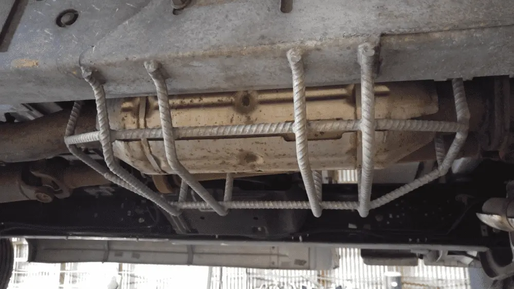

It's definitely a good idea if the car will be parked outside. The threads posted by @CX5_Driver above show some good deterrents. A muffler shop could probably weld up a cage for you using some steel rebar. It's much harder to cut through.

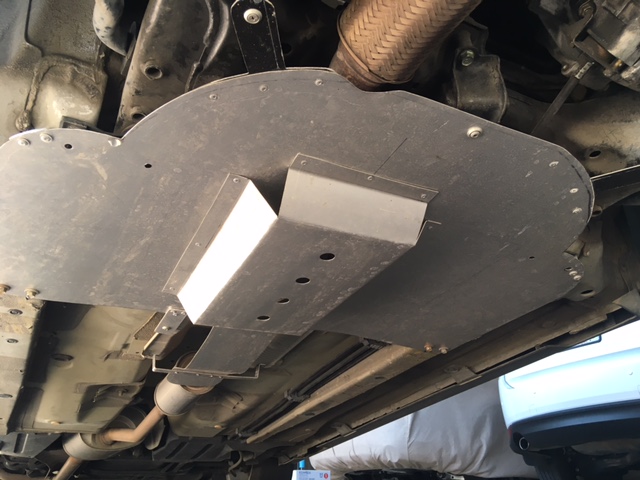

The Mazda sits indoors at night so I don't worry about it, but my Honda sits out in the driveway so I made a shield out of some scrap material I had laying around. I didn't want to go the whole nine yards with rebar welded to the exhaust or anything permanent which could make maintenance more difficult. This is just bolted on and can be removed in a few minutes. A sawzall would go through it pretty quick, but it'll still take time and make a heck of a lot of noise before they can even begin to see where to start cutting the exhaust. The car is parked 10 feet from my front door so I only need a minute to wake up and grab my favorite theft deterrent device from the nightstand. It won't prevent theft, but might convince someone to look for easier/quicker opportunities elsewhere.
Impressive looking. Did you take any pics of the shield before installing it?
I can imagine someone rolling underneath and giving up immediately.
No, never thought to take any pics prior to install. Not much planning was involved, this was one of those things where I was just curious to see if I could come up with something effective that didn't cost anything to make.
