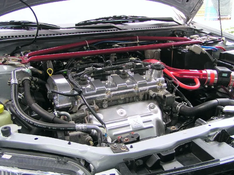

Mine's polished :)

I really like the chrome.....is that paint or did you buy something else. Same question with the Exhaust manifold shield.
You can't paint chrome, well you could but not where there is heat and it looks cheap. Its called chrome plating. To get that effect most people just have it polished and ceramic coated, which give you shine like Gurly's and reduces the heat that is released.

Looks really good. I like the red and the chrome lettering.

The metal was stripped, chemical washed, polished, copper plated, nickel plated, chrome plated, then given a final polish
that explain the 300$. If I remember correctly when my dad used to do plating its not necessary to do both nickel and copper but technology could have changed I guess.

yeah you might have paid way less but you can't compare your result to hers. You have to see it in person to understand.
