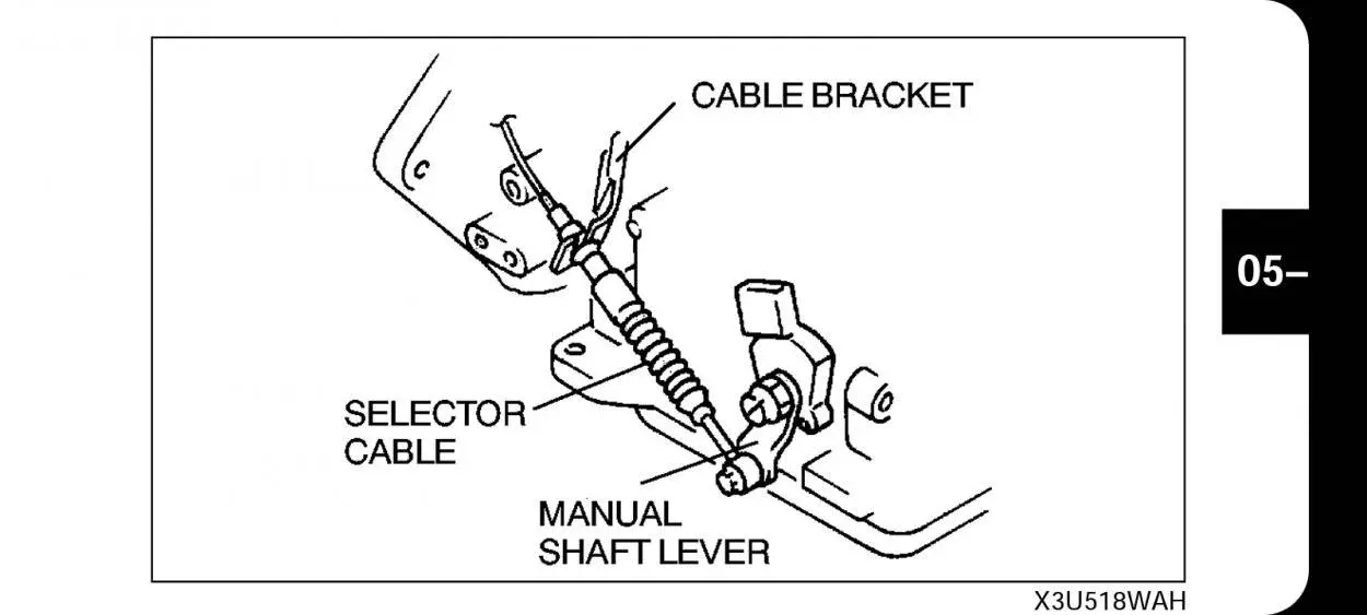

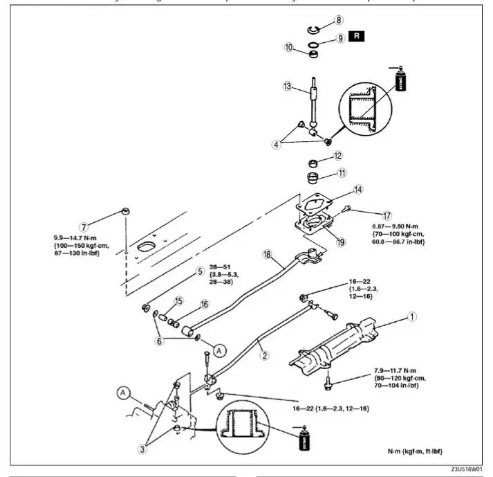

Anyway I haven’t drove it yet, just backed it out of the garage and pulled it up next to it. Whenever I did the shifter seemed like it didn’t want to move? Before it sat for 10 months it felt like it was fine, could my linkage possibly be seizing up somewhere or would it be internal? I’ve tried working it out with the car off for a few days and no progress. If the tranny is messed up, I’m selling it or parting it out lol. I’ve never had a vehicle give me this many issues before going back on the road.

I forget whether you've got a standard or an automatic, but if it were me, I'd try to lube the linkage.
My parking brake cable seized up, so I put oil in the boot to help.
Oil can creep up the wire and do a better job of lubricating.
Spray grease may not work its way up the cable as far.
Use synthetic grease/oil or rubber grease/oil.
Regular oil/grease can dissolve the rubber boot and turn it to mush.

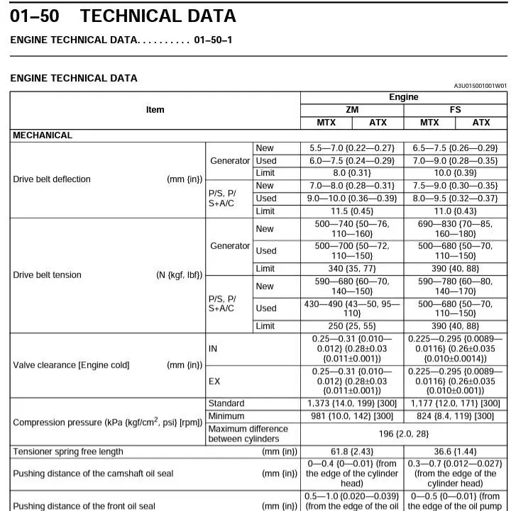

Went to move the car earlier,took it down the road and it coughed twice,then shut off. Took it home and did a compression test. Somehow each cylinder is at 60psi fml..I’m really beginning to think the car is haunted..on a positive note though,it shifted fine lmao

I have no idea why your compression would be at 60 psi then? Bent valves maybe?
The minimum compression is 119 psi. Your car shouldn't run at all with only 60 psi?
