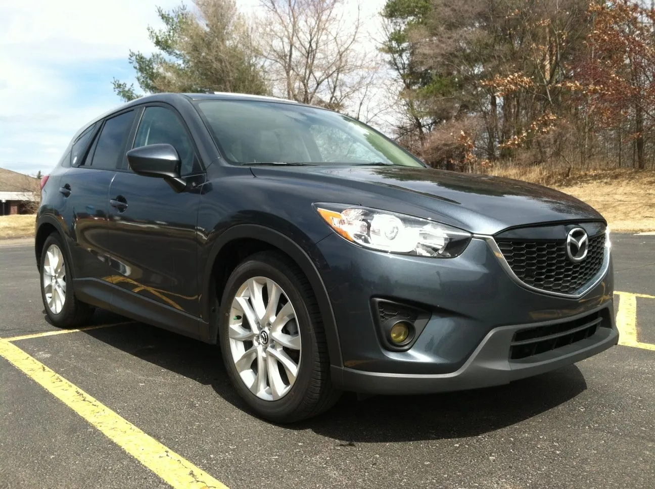

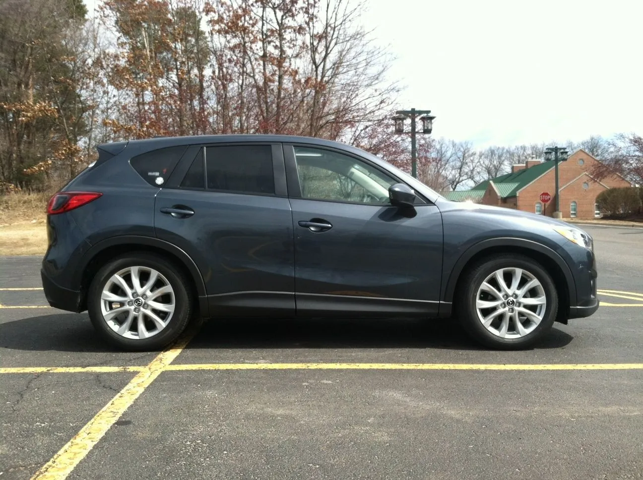

Couldn't wait, so I just posted them from the office. Not the best pictures but I snapped them with my iPhone in a bit of a rush. I'm still leaning toward black wheels, the silver just looks out of place on the MGM in my opinion. I had a MGM 09 speed 3 with black wheels and it looked very good.
Again, I am very happy with the ride height, it leaves sufficient ground clearance but changes the entire demeanor of the vehicle from an appearance perspective, especially with the 19's.

I'm pretty sure I'm going to debadge the back and I may black out the front and rear mazda emblems if I do the black wheels too. I would leave the chrome under the grill though.
I wouldn't change those wheels, they look so nice. Just change the color and install some spacers.

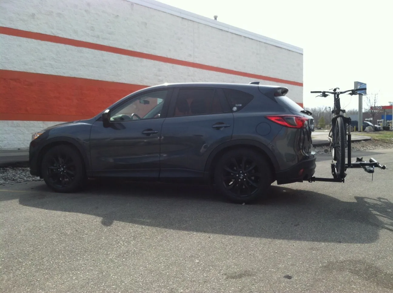

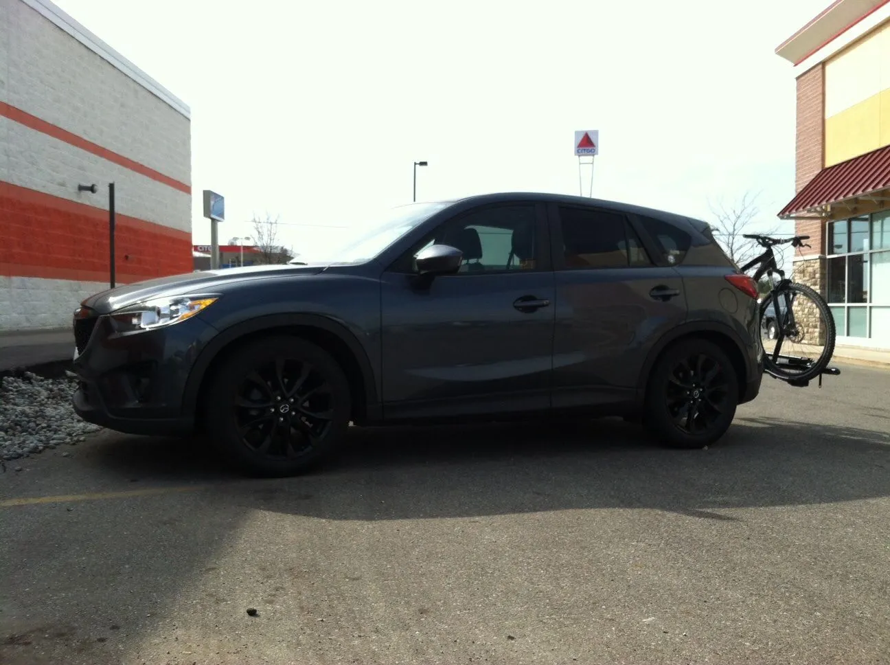

Finally snapped a couple pics with the black wheels. Not the best quality pics. I love the black so far. I will see how the plastidip holds up for a while but will probably do powder coat if I decide to stick with these.
painted black wheels looks good, i might consider this route for a while until i can save money for the wheels i want, thanks for posting
