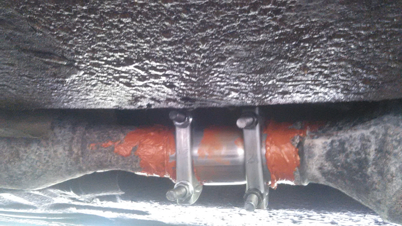

Replaced the spring bolts for the headers last night. The OEM donut ring gasket thing did not fit (the manzo headers have some donut thing already going), also tried making my own gasket out of a sheet.
Still can feel air coming out of the top of the connection and it still sounds raspy/crappy.
Picture looks like the pipe before the cat (I really don't know the name of it. I'm a newbie with exhaust stuff) has a bent lip; the header's lip looks straight and fine.
Friend suggested heating it up and bending it.. suggestions? Or maybe I'll just buy that whole midpipe/cat section and replace it.. aftermarket ideas?
Hmmmmm, the pressed steel flange will be a heap easier to bend than the place flange, can you get that section out of the car? Then you can tweak it gently with a BFH.
Otherwise you could replace the spring bolts with standard bolts and tighten them allllllll the way up until the flanges are flat, might run in to issues with them loosening off after a while.
Otherwise, a bit of exhaust gasket cement will help as well
Hey, I ran into a problem with my header flange pipe not connecting to the midpipe before, and I found out that it was because my dang spring bolts had too low of a spring constant. To remedy this, I stacked a bunch of washers in front of the spring, tightened it as hard as I could, and have since completely eliminated any and all leaks!
For you, this can help bend the flange pipe back into it's normal position using natural forces. Think it'll work for you?
Shoot, I might give that washer thing a try. Thanks for the replies guys :)
Was considering just getting a whole new midpipe etc then be done with the exhaust setup. We'll see in time!
Snapped a random pic today, got the coilovers all set at the height I want. No rubbing on hard turns etc :D
I say, cut the flanges off and do this.
It worked for me!! lol
Got the leak fixed! Actually turned out to be two exhaust leaks; the guy there pointed out that the hanger on my exhaust broke off so they welded that back on too.
They got the donut gasket in after some work, no more leaks! It sounds great again.

Good to hear you got your leak fix! It's such a relief to not have to cringe anytime you drive your car around. Where was the second leak? If your hanger broke off, thus crunching the top of the donut gasket at the header -> midpipe connection, I'd imagine you probably had a leak in the midpipe -> resonator connection.
And sweet PC, what are your specs? My gaming computer's getting quite old now...I built it 5-6 years ago, and I'm riding that i5 4670k as far as it can go. If I would've put a little more thought into it, I would've held off for a socket type different from LGA1150. That way, I wouldn't of hit a physical limit on processor/RAM/Memory upgrades on my motherboard lol!
Where the headers met the.. front pipe? Where you put the donut gasket in. Sorry I'm terrible at exhaust stuff haha.
