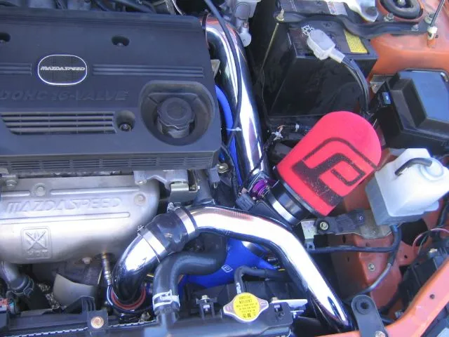

Once I can get the RPMs to completly stop dipping I will. Right now they drop low and occasionally the warning lights flash on. I've tried running the stock vacume source and the break booster line, both with the same results. It seemed to get a little worse when I put the Perrin SRI on. Perhaps it is because I can now get 3psi when revving at under idle(5500 rpms), and peak at 7+psi (1.5 over my initial stock setting) when driving under load.
This weekend, if I can find the time, I'm going to take off the greddy and reattach it with a new gasket, maybe reusing the old one is causing a slight leak (although I doubt it).
I'll also re-read the greddy instructions and see if I can use the secondary vacume source as well. If I remember correctly having a strong vacume source (brake booster line) on the top nipple will help it open quickly, and having a weaker vacume source on the bottom nipple (stock wastegate line) will help it close quicker. I'll have to double check the instructions before trying this, but it may be a solution.
If that doesn't work I'll give it another week for the ECU to relearn my driving style and see if it improves. If at that time the rpm dipping issues are still there I'll switch and start recirculating the greddy. I love the sound, but not at the expense of a possible accident.
Until I can get it running perfectly I don't want to steer any other forum members in the wrong direction.
I will however, include a pic of my current set up:
