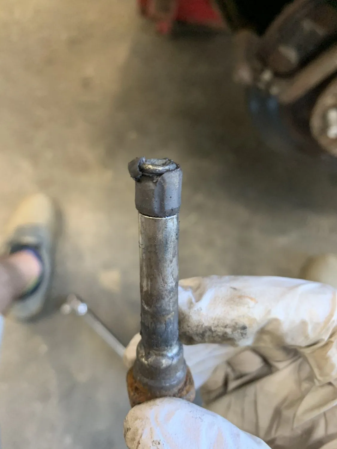

Has anyone noticed that the caliper pins are different top to bottom? One of them has a small rubber sleeve about 1/2” long at the tip, the other does not. I may have inadvertently put mine back in the wrong spot . Anyone know if the pin with the rubber goes in the top or bottom?
Usually bottom. Some calipers come with pins where both have the rubber sleeve on them. It is supposed to be anti-rattle. In truth it is not critical that it be in the top or bottom position. The sleeve on your pin looks a little worn out and might be replaced. The rubber sleeve is often included in a caliper hardware kit- along with shims and caliper pin dust boots. The caliper pins themselves can also be bought - usually without the sleeve.
Has anyone noticed that the caliper pins are different top to bottom? One of them has a small rubber sleeve about 1/2” long at the tip, the other does not. I may have inadvertently put mine back in the wrong spot . Anyone know if the pin with the rubber goes in the top or bottom?View attachment 225317
I recall asking the parts dealer that same question and he mentioned that the black piece was part of a rebuild kit or something but I'm not entirely sure how accurate that is.
