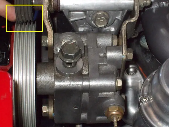

Finally got around to installing the powersteering pulley (got here late, so it had to wait), and the grooves are machined incorrectly.
I saw a few other people mentioned it, but it was never addressed by Brach.
Installed the lightweight accessory pulleys from Brach saturday. Either the PS pulley grooves aren't spaced quite right, or my belts are off. The belt gets a cup shape once installed because the ribs don't mesh with the grooves properly. New belt I bought jumped a rib when I turned the car over the first time. No visible problems with the other pulleys.
One guy mentioned that since it didn't squeel, it'll be ok for him.
But I paid too much for the pulley to tear up belts prematurely; especially with how bad the alignment is on this one.
Pictured is the old belt.
I purchased a new belt as well, which lined up the same way.

Correct, look at the belt compared to the pulley. How far it's pressed or not is irrelevant to the belt/pulley not matching. Mine wasn't like that.
Maybe the question that should be asked is what brand of belt was used in that picture VS what i12drivemyMP5 used...
I had goodyear gatorbacks before pulley swap. Used same belts after swap, have no noise, have no belt destruction & it hasn't come off or anything like that. Took 1 extra adj to stop squeal & that was only for a few seconds when turning on AC compressor. Retightened both a tad & no more squeal. It does appear that the back edge of the belt is microscopically raised compared to oem but nothing that's causing a problem but definitely not off like the pic that was posted. The front of the pwr steering pulley is completely flush with shaft like oem was.
It's a Gates belt, not that it matters.
It's not like it's close ... its way off. And I've got a new belt that has the same spacing.
The groove width on serpentine belts are the same car from car, so I could use an OEM Toyota belt on it if it's a 5-grove and close enough in length, but it wouldn't matter if the pulley's machined incorrectly.
Speaking of, the belts used with a 2.0L Unorthodox UDP are off a Dodge Minivan & Mitsubishi Montero. Industry standard groove widths.
Brand would be relevant if we were talking about noise, but I'm talking about physically not fitting.
Gatorbacks are more forgiving of pulley damage, misalignment, etc because of the serration and extra groove spacing (ie - smaller ribs). IIRC, that's why they were designed.
I shouldn't have to use a trick belt (such as a Gatorback) to use a pulley fashioned for OEM fitment. Especially since I've got low mileage belts already.
Even with your "trick belt", it's still not perfect, just driveable.
That still indicates a pulley problem.
Well, I don't think perfect exists much these days. The belt isn't cup shaped if you look at it where it's on the pulley. It's only noticeable because I'm all obsessive compulsive about every nut/bolt/setting on the car. Not sure anyone would even notice it. Like I said, it's nothing like the pic above, it just feels like a new fat unused belt vs. a used one. I don't drive at WOT every second the car's running or nothing like that but it has visited that on more than a few occassions & I have no qualms about it's fit or longevity. It has been plenty tested. That one in the pic is nothing like mine. I compared mine to oem when installing & overall it didn't look measurably different.
Hmm ... guess I'll have to bust out the dial caliper and compare Brachs pulley vs stock.
Side by side they looked the same, but that was just eyeballing to make sure it's the correct part before installing it.
The face of my pulley is flush with the pulley hub stub, so I'm not sure why everyone's saying it looks like it's pushed on too far.
And by 'perfect', I meant a belt that rides like it's designed to.
It's supposed to be flat; if not, it indicates a problem.
