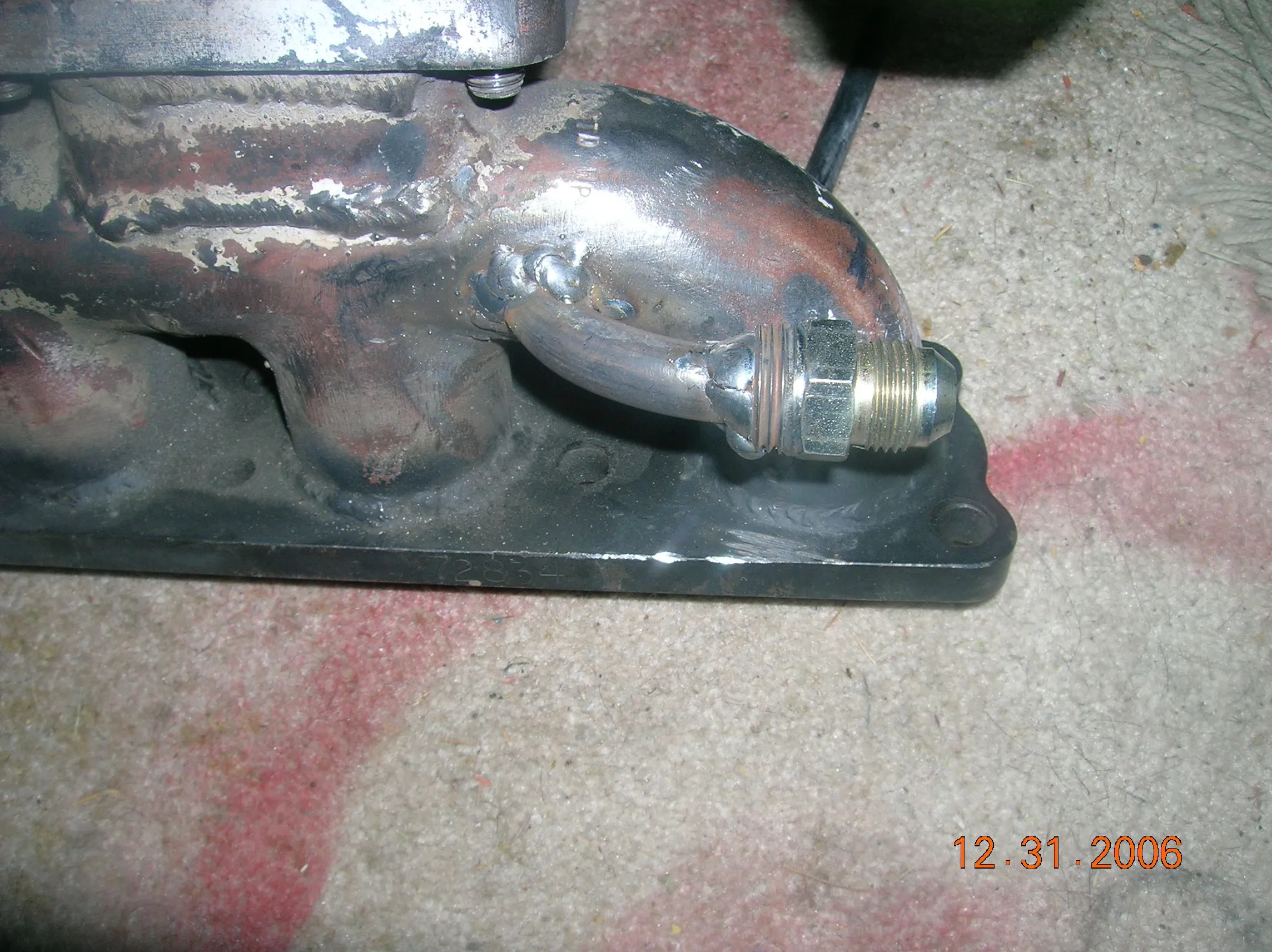

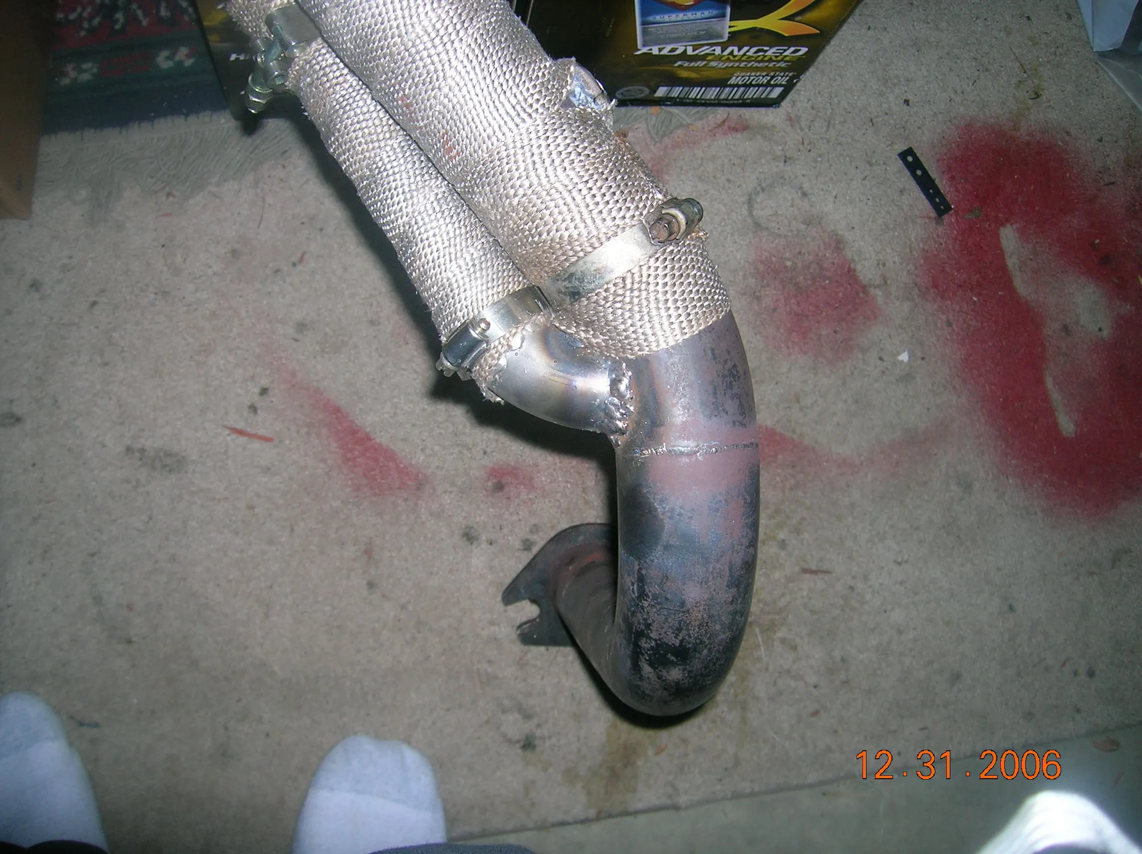

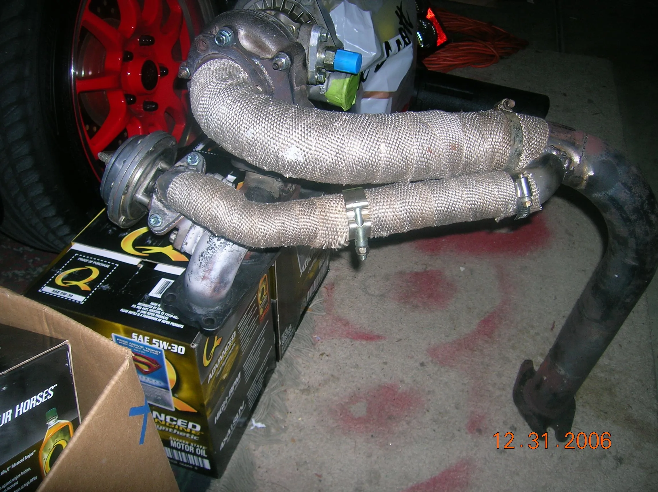

1. when i got the turbo kit i had a problem with the egr pipe on the manifold, it was broken off on my turbo manifold. so after a thread on the fourm, i was told i could just seal the hole. so thats what i did, but the tube that goes below the TB was all messed up. at that point i ordered a replacement pipe from ken and have been holding on to it all this time. well i took the car in for emission and failed the ob2 plug test.
2. when i was driving hard the waste gate just bugged the hell out of me cuz when it open u could hear it very loud. so i planned one day to get it fixed. after failing the emission test, i had to fix the problem soon.
so here is the finished manifold.

projectmx said:
dang that is pretty... i need one of those for my bp... did you weld that egr pipe on?
no a shop welded the pc. so that i can hook up the pipe that goes to the intake manifold
Captain KRM P5 said:
i think this is the only protege with a divorced gas downpipe
things have not been going to well 4 them so they split up. (gossip)
well i got everything back in the car, its alot noise. i also got the awr side mounts in (been seating in the garage almost a year), oil change and new bulbs 4 the fog lights.
