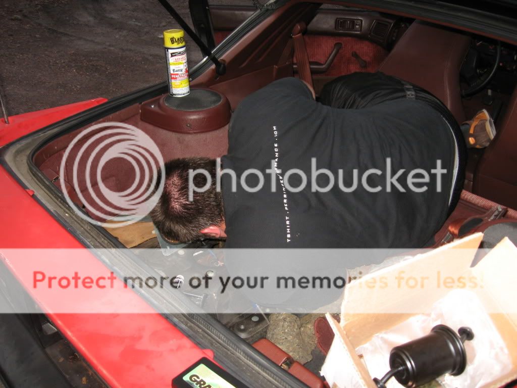

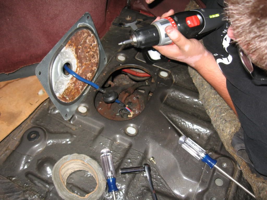

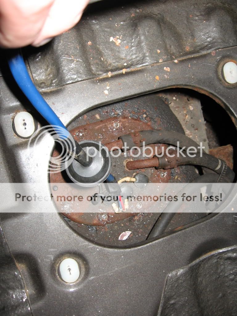

well got the car to my place, fires right up with starting fluid. Just having a b**** of time with the dam screws to get to the fuel pump and i ran out of sunlight. So hopefully tom. ill be able to get it in.
But for today i got the title and change some fuses.
a fat kid in a small place haha.
dam screws suck

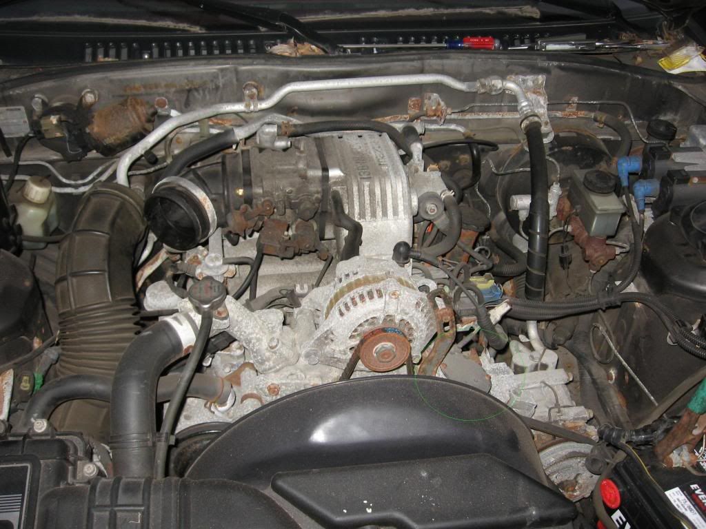

on this pic there is a faint green circle, what is this block off plate for? also to the right of that a lil there are two green connectors that have nothing connected.
That block off plate it factory. Basically a dust cover for the ignition timing pickup, sorry I don't know the actual name. Good luck with your RX!
Can't see the green circle or I am not looking in the right place but there should be green plugs not connected to anything by the strut towers on both sides. I know on the drivers side is how you get the codes for a s5 not sure for s4
The circle is faint, it is to the right of the alternator just below it. Your Were's Waldo skills will find it :D
Ahh ok I see it now...doesn't help I am trying to see it on my phone...neway yeah that's the factory CAS cover and your right its the timing pickup...that's where the distributor goes on a non efi car.
