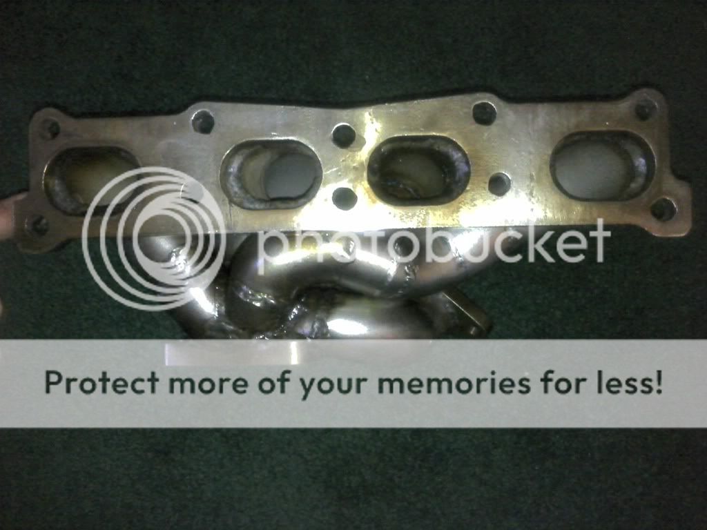

Here are the requested pics.
that looks really great on there. considering a swap to EWG, but what housing would i need to get to run the stock turbo with EWG? then i can stick to the EWG when upgrading turbos later.
Either have the internal gate welded shut or leave the actuator in place to keep the flap shut, then you can run ewg
no flow issues doing that? not sure what i wanna do with the car down the road, probably just a 2860rs, as its proven. Would there be any severe negatives to getting it with vband EWG and just capping it until i wanna use it?
people do that all the time. no issue.
Thats what I plan on doing and you can buy the caps or block off plates on ebay for about 25 bucks if i remember correctly.
My engine bay would look funny with two pipes sticking up that dont go anywhere lol i might do that then. My msp wont be getting a monster turbo. Just enough for 250 reliable hp after i rebuild it. Maybe a little more up top.
