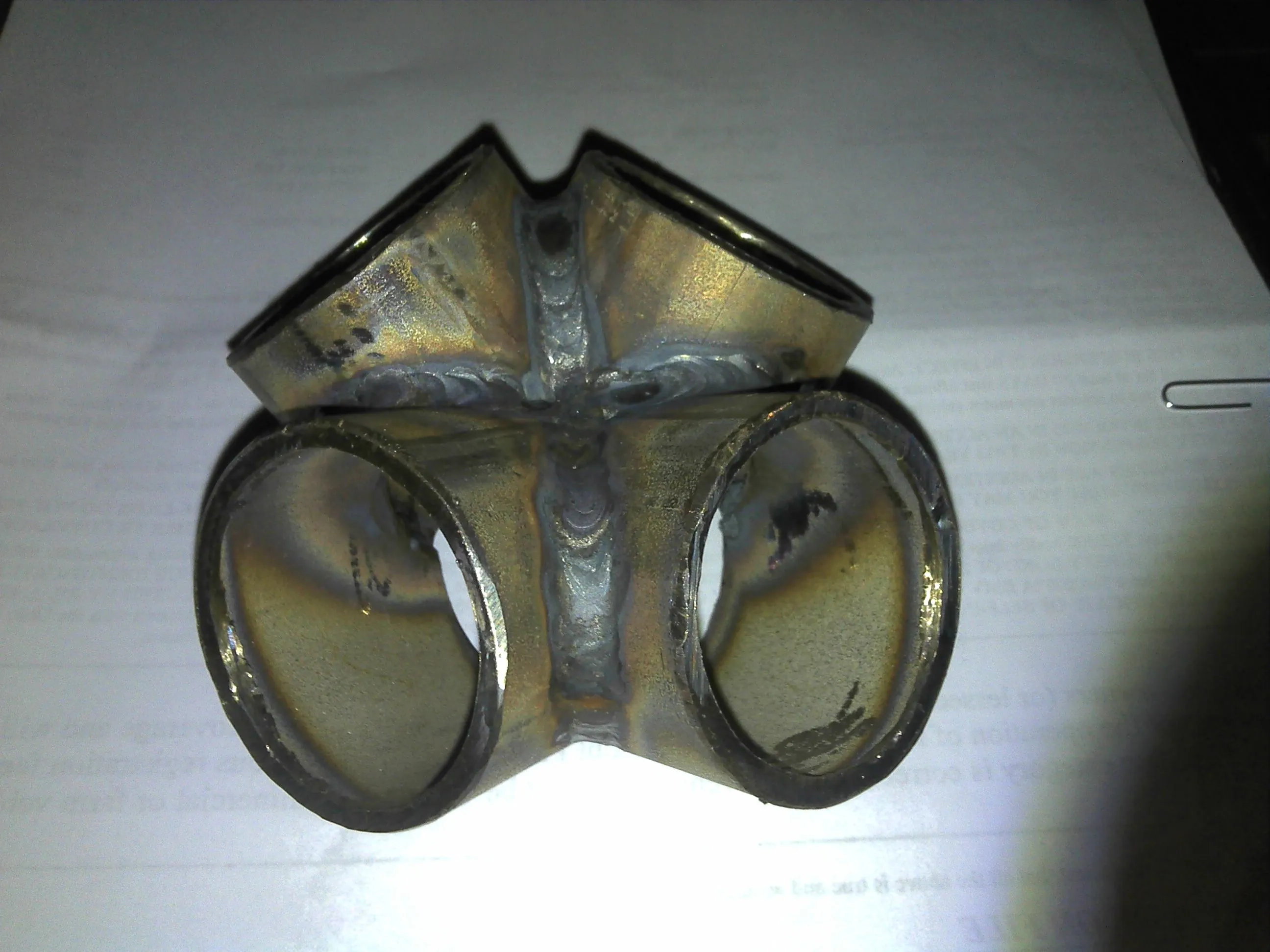

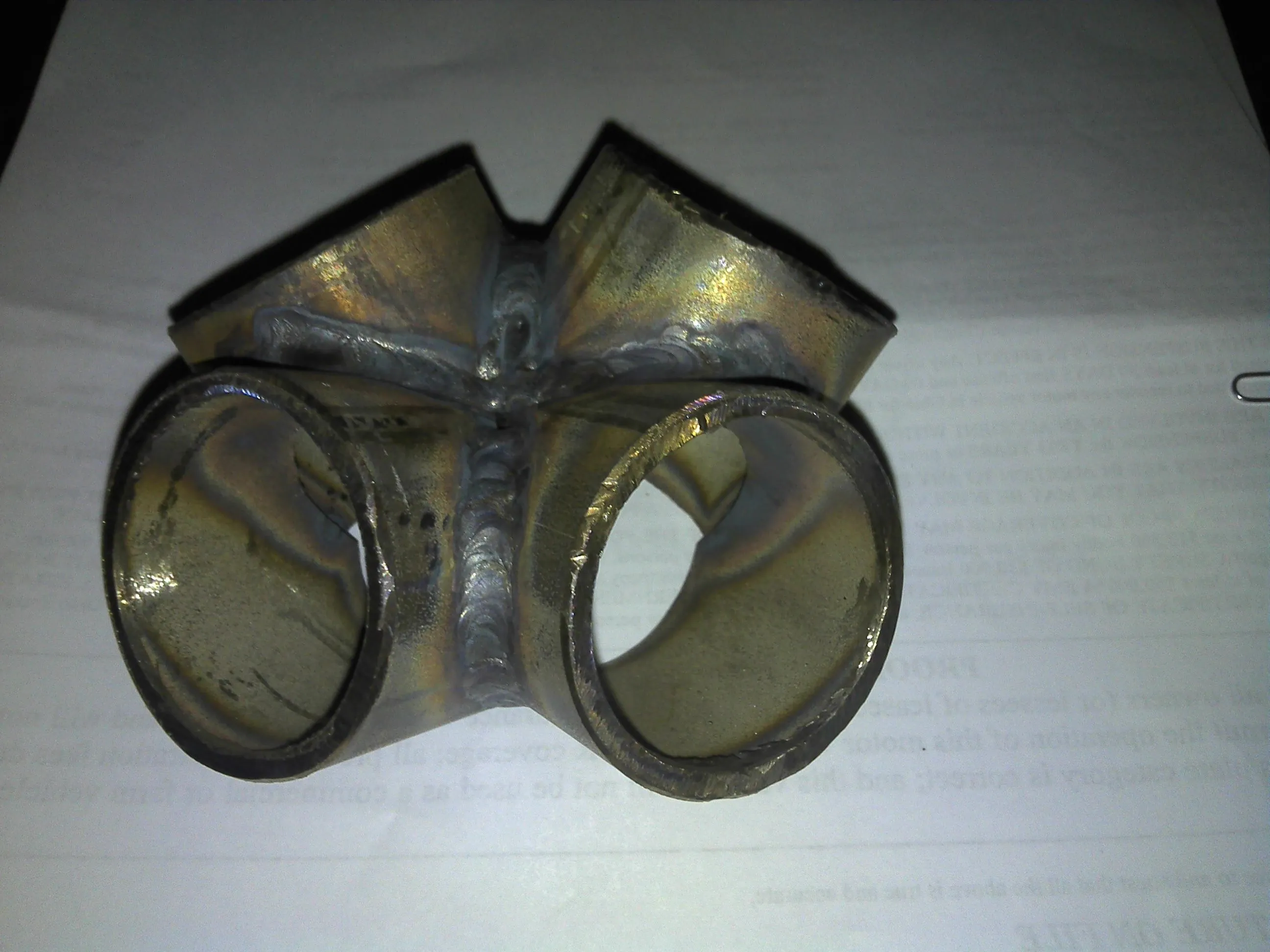

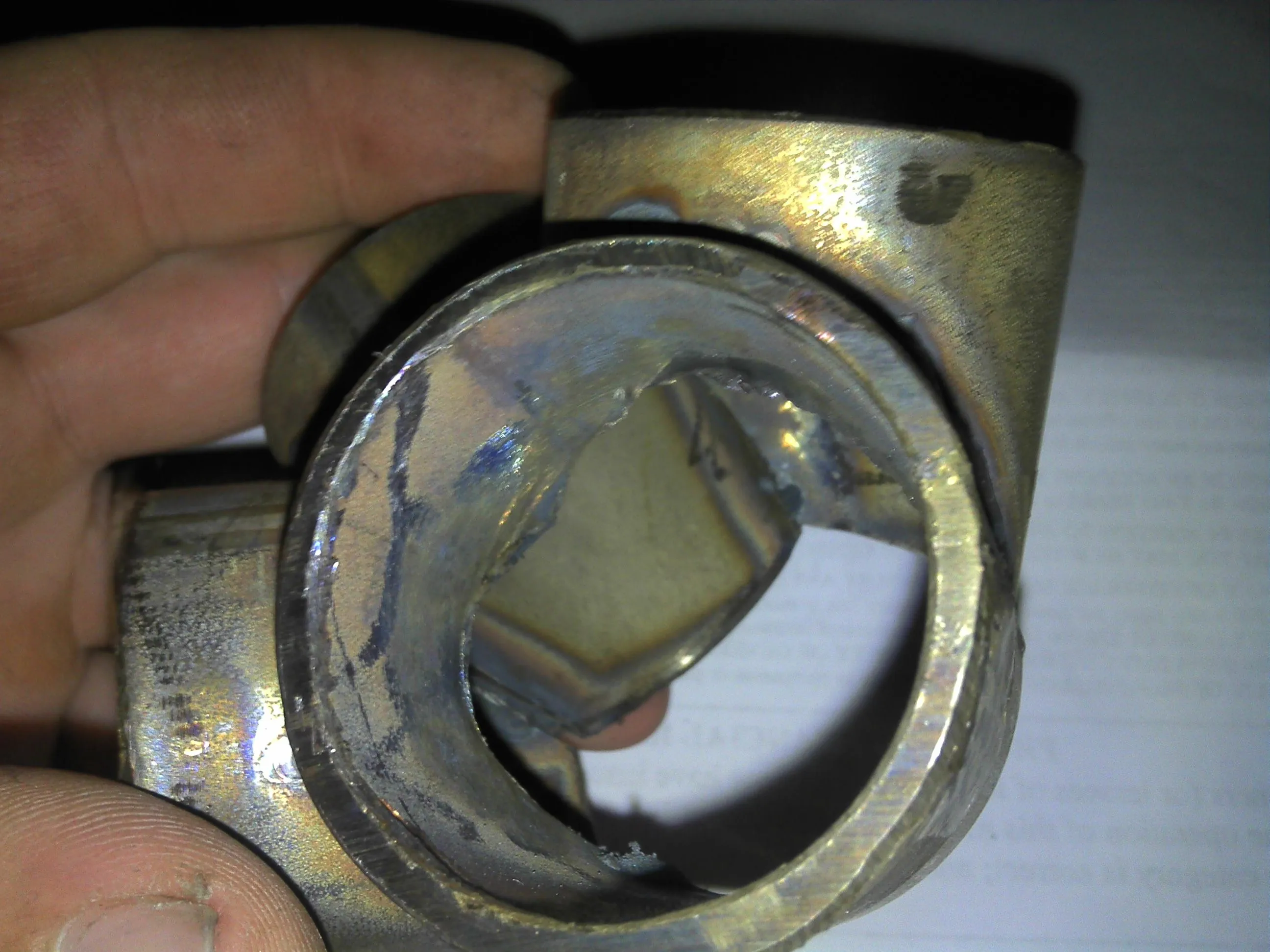

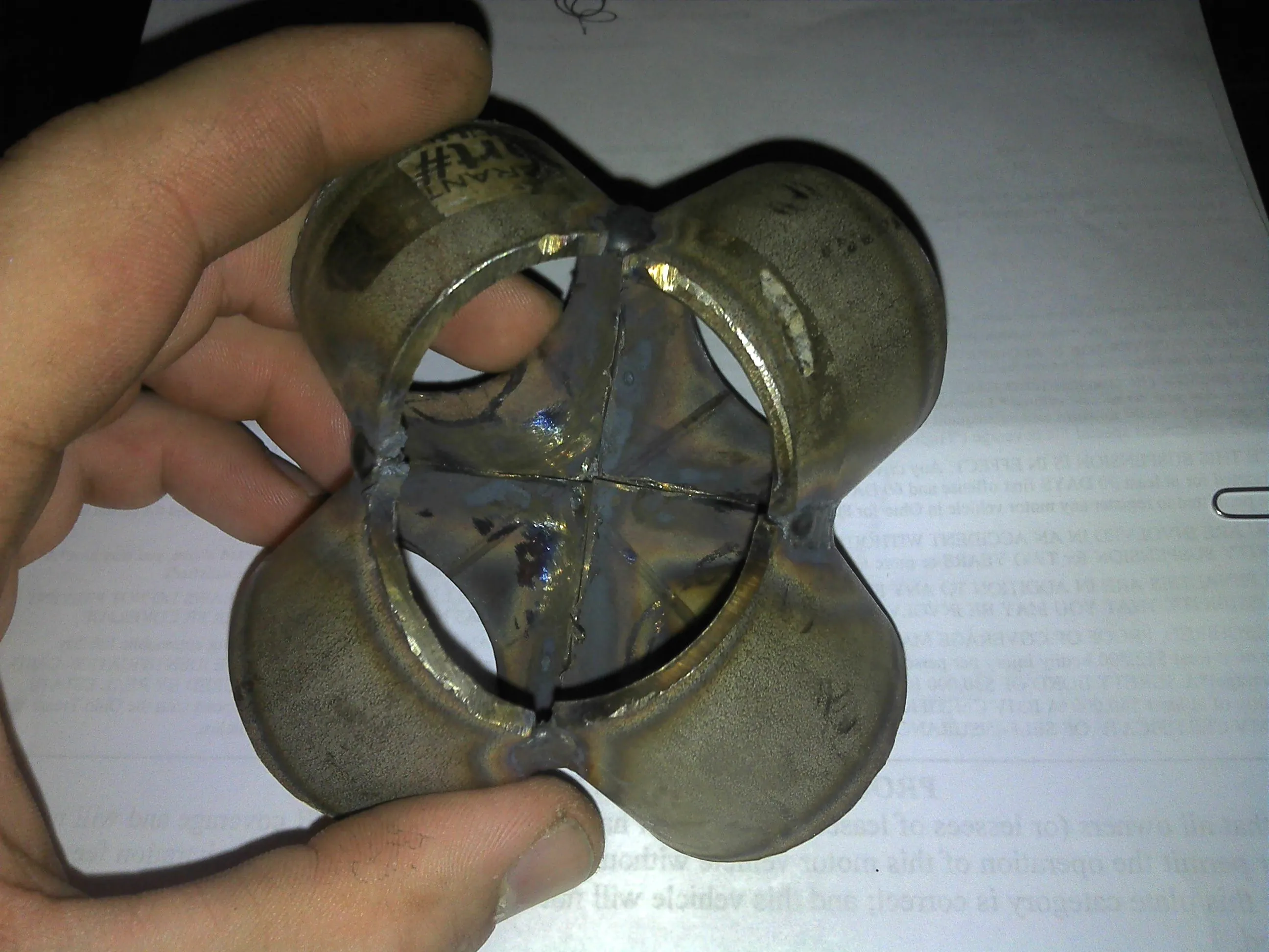

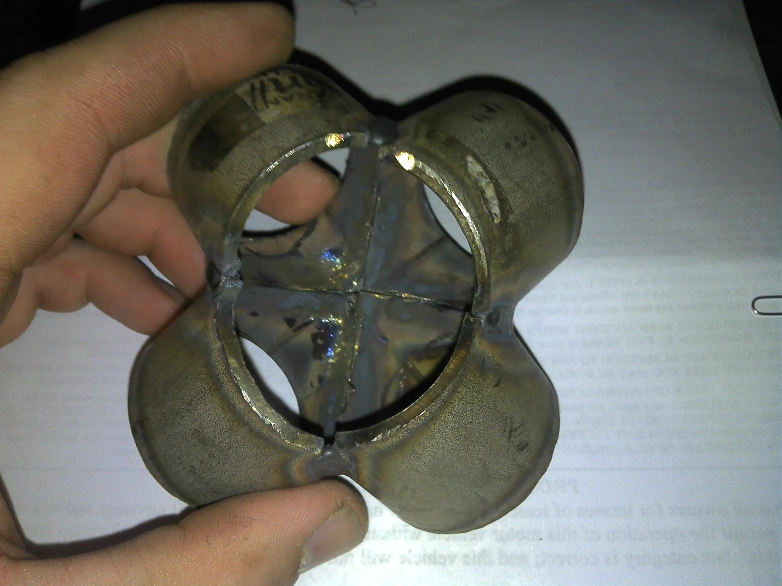

I have an update!
Lots of progress has been made. I already had the jig made for assembling the manifold itself, but now I also have a jig built for cutting the pieces for making the custom merge collector that I need. This afternoon I got the prototype collector assembled (but not totally finished) and I mocked up all the runners. They will get tacked tomorrow and I'll take more pics. I'll be shipping the first customer manifold within a week or two. This thing is going to flow and look awesome. I'm excited.
