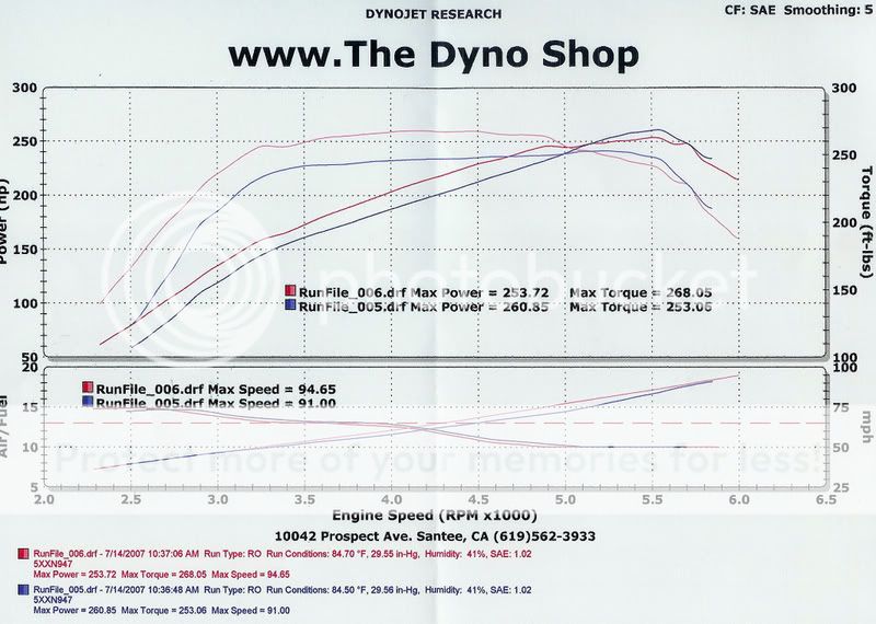

Sorry to dig up an old dug up thread. But I didn't think I had the problem until I did a recent dyno and read this thread.
I'm intermittently losing power. Check out the second pull. It was much higher than the first pull, but loses power at 5k RPM's.
