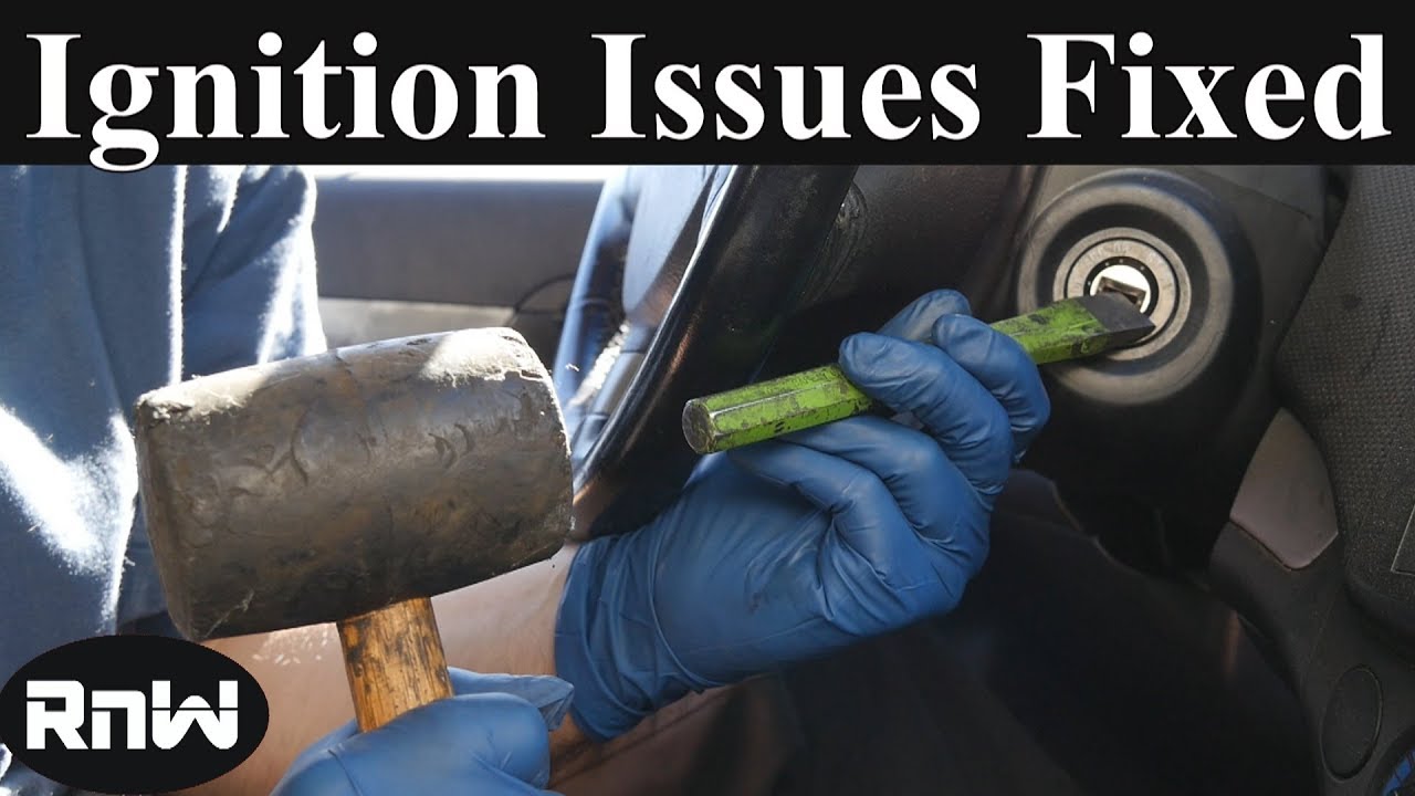

You can always try:
I am sure they make it sound easier than it is.

You can always try:

Thank you! I was able to use the hammer method to get the cylinder to turn and exposed the release pin. After the cylinder was pulled out, everything went smoothly from there. The plastic fragment was removed and I even managed not to lose any tumblers or springs. The stock key worked seamlessly after the cylinder was cleaned and regreased and put back into the car.
