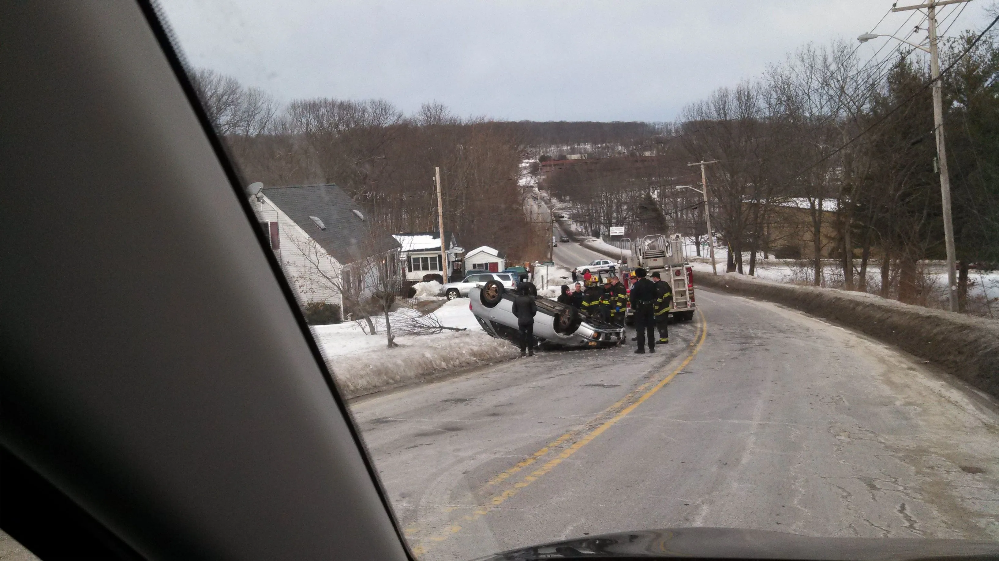

Perfect example of how AWD can get you in trouble because it gets you going in a hurry but doesnt offer better stopping. You can see the girlfriend standing on one side probably thinking why am I with this idiot and the driver on the other side holding his bloody nose. This happened in my neighborhood a few weeks ago. I finally got the chance to post it now. I swear every time I see a vehicle on its roof around here especially after a snow storm its an AWD vehicle.

Perfect example of how AWD can get you in trouble because it gets you going in a hurry but doesn’t offer better stopping. You can see the girlfriend standing on one side probably thinking “why am I with this idiot” and the driver on the other side holding his bloody nose. This happened in my neighborhood a few weeks ago. I finally got the chance to post it now. I swear every time I see a vehicle on its roof around here especially after a snow storm it’s an AWD vehicle.
There is no snow on the road or anything. What caused his crash? I assume it is stupidity...
Where in Ma is that. I lived in Wilmington for 33 years - just curious
