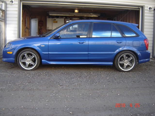

Here are some pics of the car as it sits now. I bought this car brand new in 2003 and it is stock except for an AEM intake, tinted windows, aluminum grills and 17" rims for the summer.

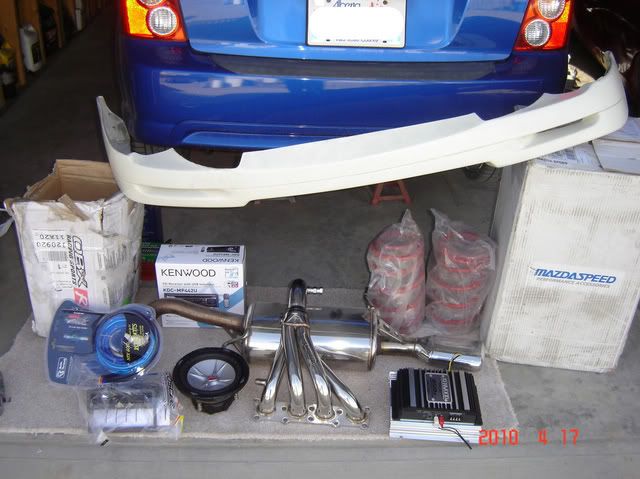

Now the last pic below is of the parts i have collected over the last year or so. The parts i will be installing are: MSP RB axleback, OBX header, MSP Tokiko struts with MSP Springs, DGM Front lip (fiberglass replica), Kenwood head unit, 2 amps, and a 8" MTX sub (plan on doing a stealthy fiberglass box in the side of the rear hatch area.

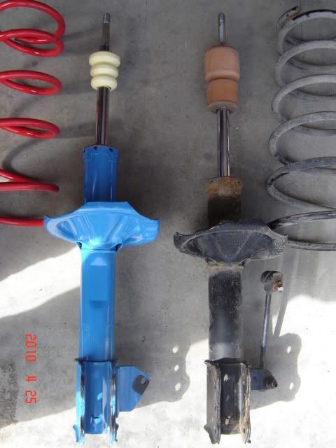

Just a heads up, due to the different perches between the MSP and the P5 the MSP springs will leave you with a bit of a droop in the rear.

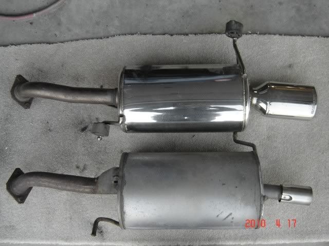

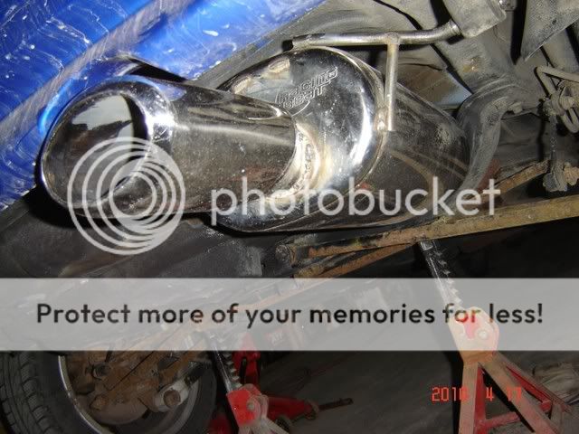

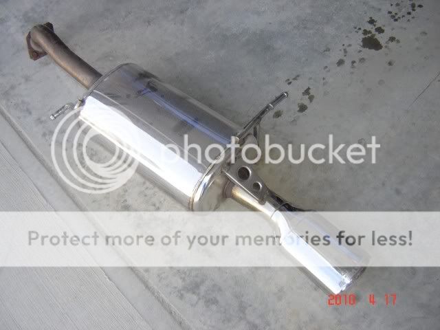

OK the MSP axle back is in and sounds great!

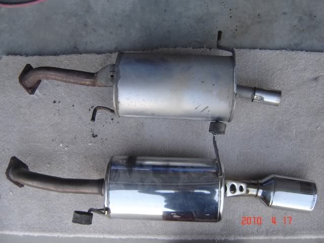

Original Axle back:
MSP Axle back:
Side by side old/new. MSP one is 4" loner out to the tip.

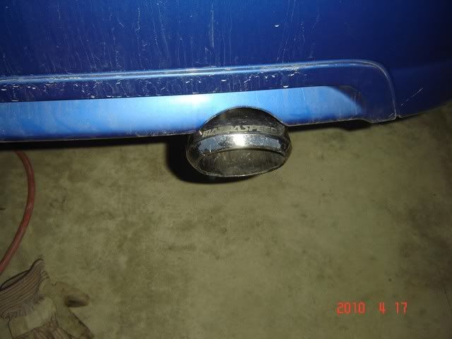

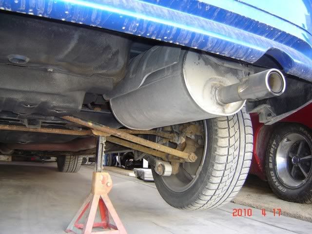

After some cutting and welding (the fun part). Pretty much cut out the whole section between muffler and Tip, you have to be careful to keep the angle going out to the tip.
And installed on the car, looks great!

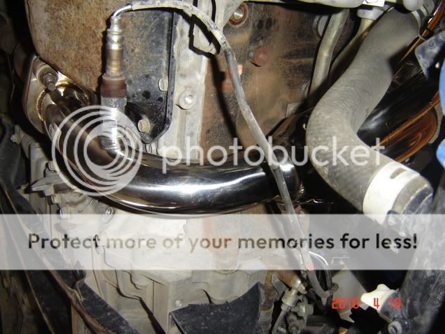

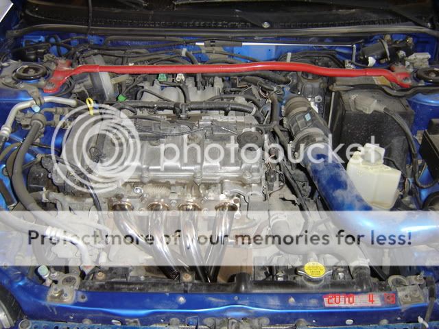

Header is in, sounds great, i was worried that the header would make the exhaust too loud but there was not much of an increase in volume so i am supper happy and the car feels great.

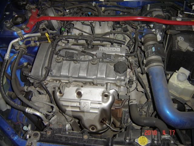

First, my dirty engine bay:
Now with the new OBX installed:
Under car, Non-fouler installed. The flange did touch the oil pan so i had to do some pounding to gain some clearance:

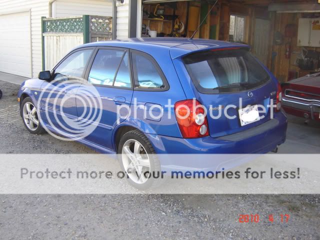

Nice mod action. I actually like the grill too. The body colored evil M makes it cool....and different from what most others have................................Now, how bout a bunch of pics of what you're blocking with the P5 sittin back there in the garage?
Yah the evil M/grille combo looks great in person.
Haha, i thought that car might come up. 1970 dodge charger 500. 383ci magnum w 727 torqueflight. My future project when time and funds allow.

Because people have complained that it (Mazdaspeed axle-back) is loud, i DO NOT want a loud exhaust that drones on the highway. I drive on the highway everyday to/from work. The Racing beat one is perfect for my needs/wants, plus the price was right and fit my budget. If i did not have the capacity to modify the part myself then no i probably would not have bought it, but since i can weld then hey why not? It was a pretty easy job in the end and i am satisfied with the results.

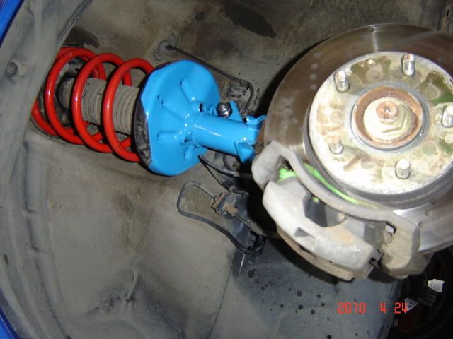

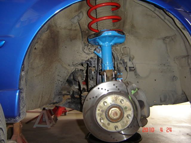

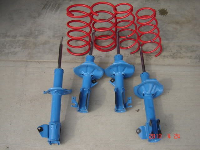

MSP Spings and Struts are IN!!!!!
A huge thanks to Jamesk for the great deal on new MSP Tokiko's, and Matt22 for the MSP springs.

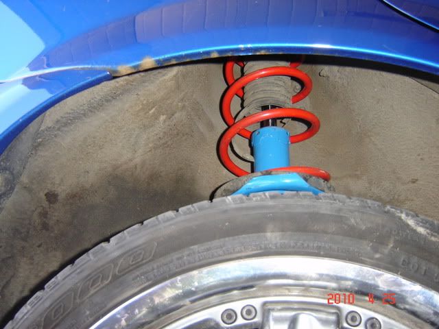

Comparison between P5 and MSP rear Stuts, the MSP tokiko strut perch sits higher than the P5 strut, this is why people get the "sag" in the back when MSP springs are installed on the P5 struts. Getting real MSP struts lets the car sit properly.

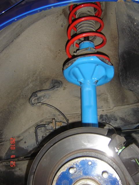

Fronts IN:
Rears in:
Couple of pics with her sitting on the summer 17's. Nicer stance with the MSP suspension, like the look, not to aggressive.
Pretty happy with it. I have not been able to really test it out though because i ordered the wrong End links for the rear so there are no rear end links installed at the moment so she handles like a boat.

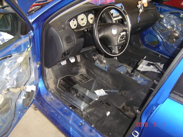

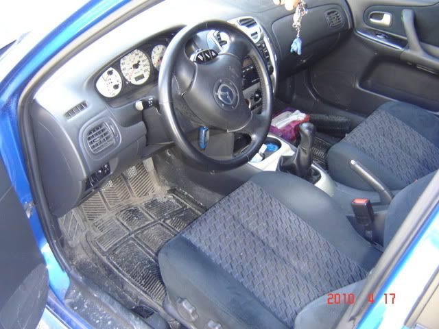

Installed my stereo on the weekend. Here are the install pictures.
Interior pulled apart, looks like disaster.

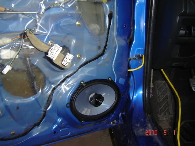

Front speakers are in (JL 5x7's)

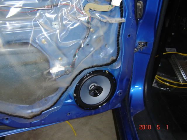

Rear speakers are in (JL 6.5")

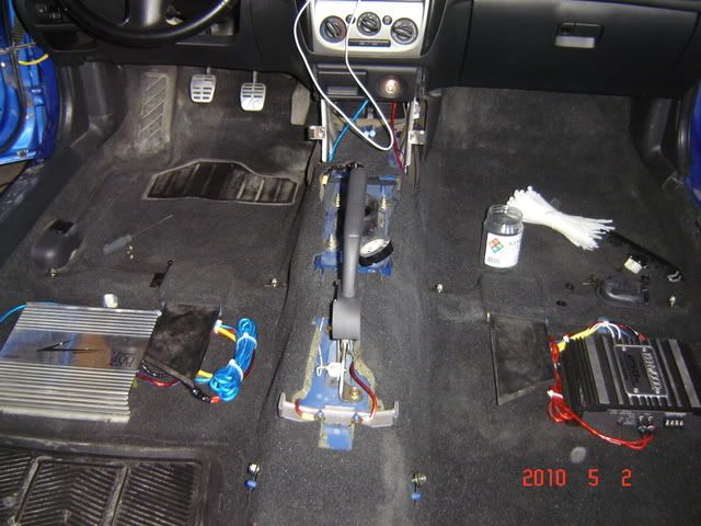

Amps installed, one under each front seat.

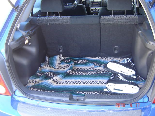

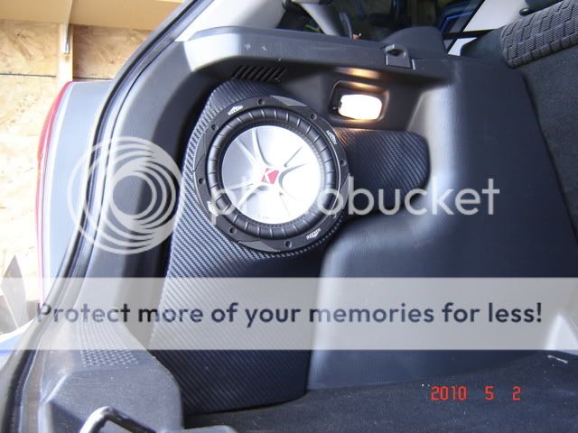

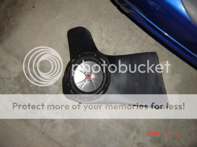

I decided to go with the stealth sub box in the hatch, i basically followed this HOW TO: http://www.mazdas247.com/forum/showthread.php?t=123669109

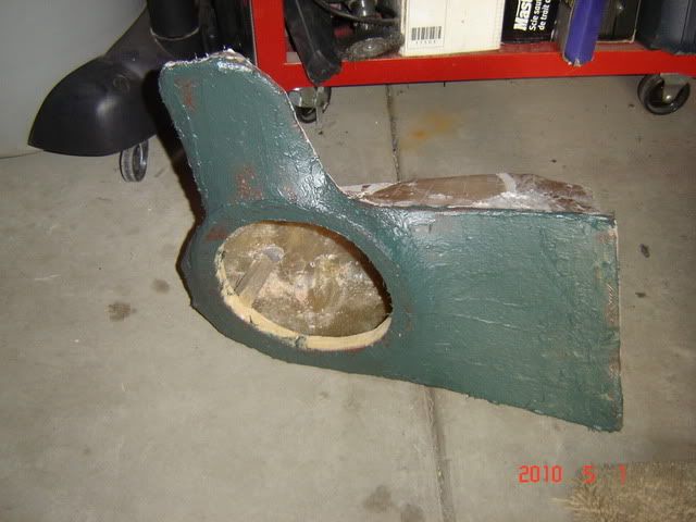

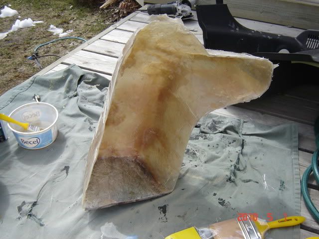

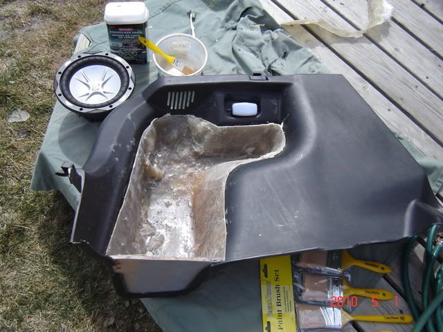

My first time doing a fiberglass mold like this. here are some of the progress pictures and the final result.
Mold done and trimmed down to size:
Then the sub ring was made and mounted using 3 sticks of wood and a hot glue gun. Then stretched fleece over the entire ring and mold then used hot glue to secure it. Covered all the fleece with fiberglass resin, and another layer on top with resin and fiberglass mat. Then a layer of fiberglass bondo (green stuff) to smooth it out.
Sanded it all to a somewhat smooth finish (far from perfect) and covered using that 3m Vinyl Carbon fiber wrap.
Re-installed side panel in hatch and mounted sub box using Velcro. Took some corners going mock 10 and it seems to stay in there. It looks and sounds great!

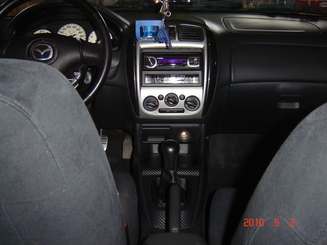

Here is a pic of the installed kenwood head unit. Dash and interior all nice and clean.

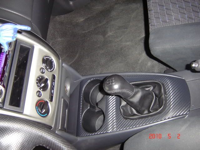

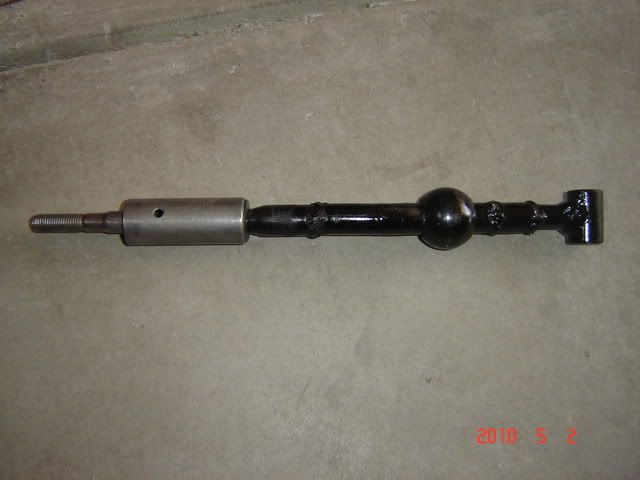

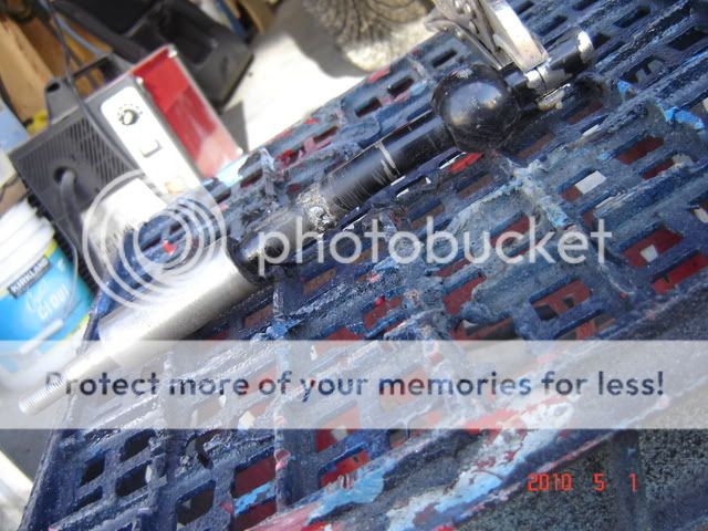

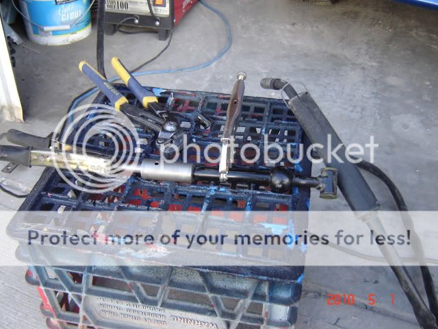

Since i had the interior apart for the stereo install, i decided to cut/weld up my own short shifter.
First i removed the shifter from the car. I cut out a 2" section above the pivot ball and below the boot stop then welded it back together. This will give a shorter look to the shifter and will sit nice in the boot.
Then i cut below the pivot ball before the shift rod mount. I took the 2" section of rod i had cut out above and shortened it to 0.75". I then welded that in between the pivot ball and rod mount. This is the part that will shorten your throw to give a true short shifter.
Lastly, welded back on the shift rod mount and gave it all a coat of paint to hopefully help with rust. Finished!!

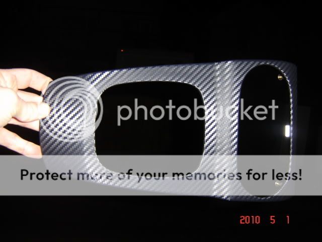

Covered the console piece with 3M vinyl carbon fiber wrap to give it a nice look (the paint on this piece was all scratched up).
All put back together, looks rad if you ask me!!
Thanks to my buddy Sean who helped me with the carbon wrap, we were both virgins at it but he seemed to have the soft hands to get the job done.
The shifter works awesome! nice short throw, feels nice and firm now, not a lot of slop like it was stock. I highly recommend this to anyone who can weld, the job can be done in about an hour or so.
