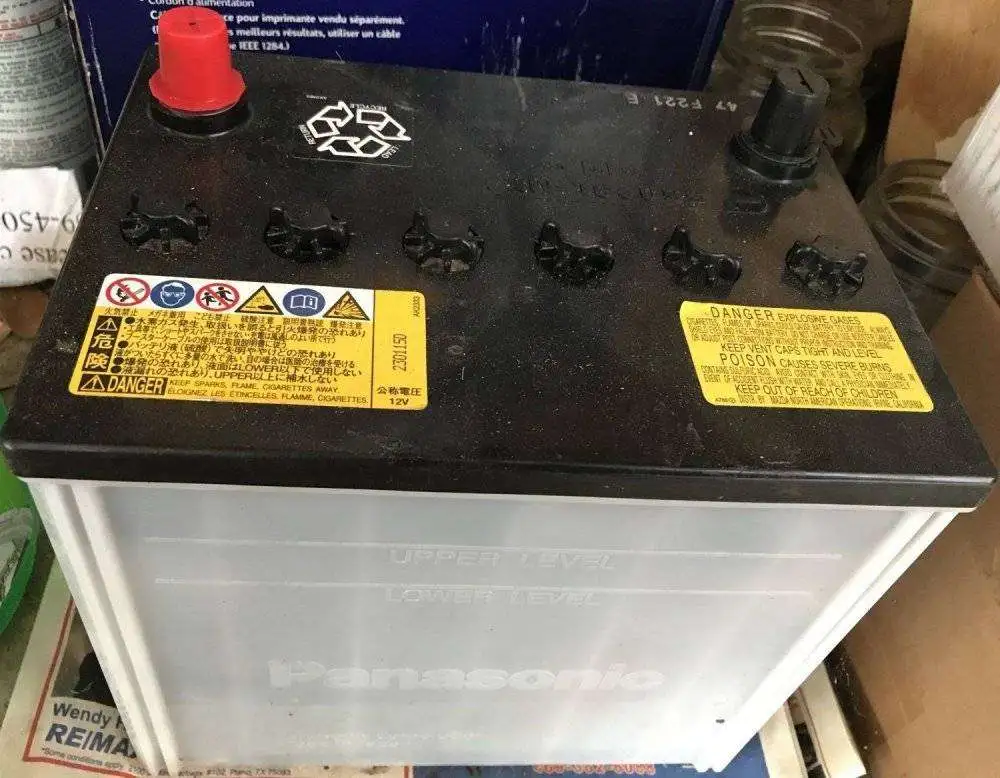

What is it with the funky battery filler caps. Do you need a special tool to take them out? Tried one time to do it to check the water level but no luck?
if trying by hand , it wont work. At least on mine. Had to use a small adjustable wrench the first time. also make sure the area around the caps is clean of dust. I used compressed air first then wiped everything.
this is where I attached the wrench.
well, the good thing is those batteries can be serviced and last long enough if done properly. They are "masked yuasa" which is a good brand. Its rare nowadays to find new replacement battery that has easy access to the caps. Try with tools and it would work out.

Not sure why you said the factory Panasonic battery used on the CX-5 the “masked Yuasa"? I believe Panasonic and Yuasa are 2 independent battery manufactures in Japan.
If the filler caps are too tight, I just use pliers to open them.

If you think that the filler caps are funky then try to fill it with distilled water, which is even more difficult since the level is not easily visible.
the battery side cover (the black plastic) has 2 openings. One that is visible from the engine side and one from the rear. The case of the battery is translucent. Put a flashlight from the rear and check then level from the side.
Caps can be twisted off with a small pliers. I usually use a small 3 oz paper Dixie bathroom cup with a few ounces of water in it at a time. Cells shouldn't be "filled", just to the bottom of where the fluid touches the cell filler hole. Distilled water only. Might need a small mirror to see the back cells.
Well I used a pair of needle nose pliers to get those caps off. So I overcame another manufacturer anti DIY joy! By the way all the cells were low but over the plates. Now they are all filled! I'll have to keep a closer eye on them.

I guess these battery caps just pull out ? they don't have threads correct ?
I'll try putting a flashlight behind the battery like cz5gt suggested.
since putting light on the engine side didn't reveal any level.. not
unless the level is so low it's not showing up.
thanks
ok , thanks for the info , I'll get my needle nose, small
dropper, distilled h20 and flash light ready for high
maintenance project !
