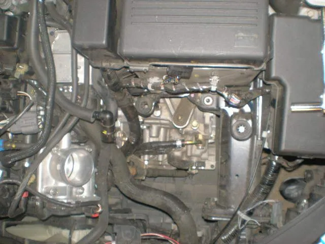

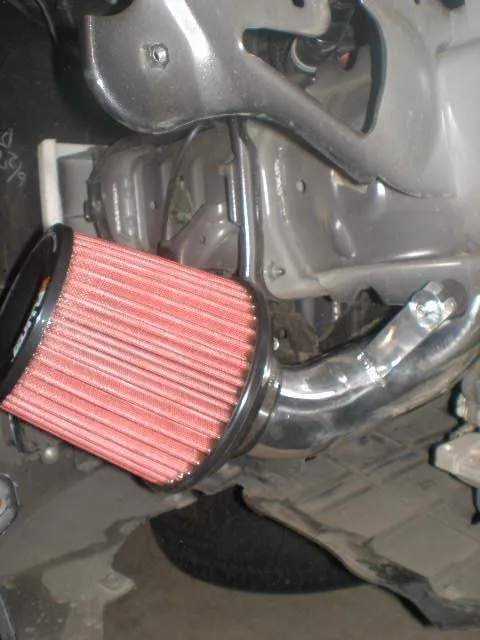

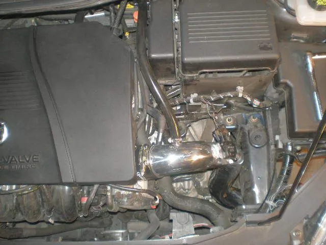

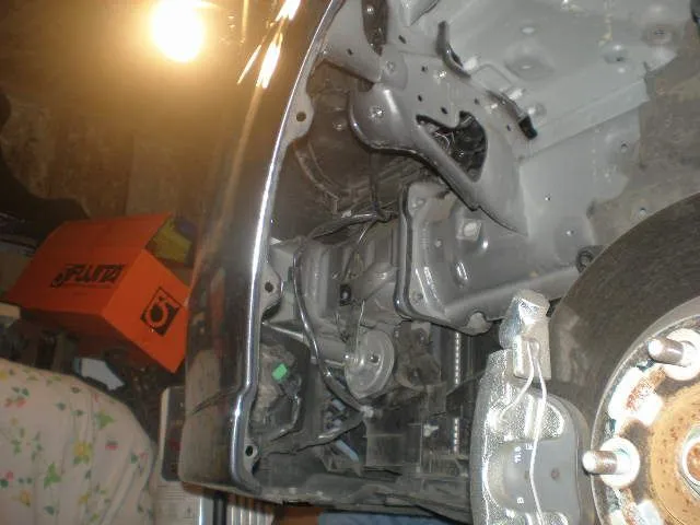

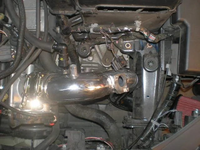

hey i got one on my M5 and it wasn't too hard, all i had trouble with was the bottom air box ,2 of the screws were alittle hard but i didn't take of the front bumper. it took about an hour and i have noticed a good amount of difference in the begining .but i also recommend a hydro sheild from AEM works great to keep out water. i got my fujita CAI from a place down the street from me and paid $160+30 for the hydro sheild. there website is www.speedconcept.com anyway hope that helps and here are some pics.
