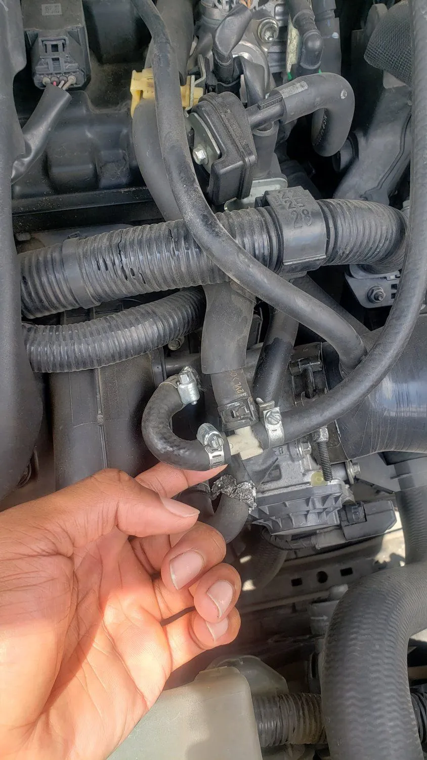

I have a tee, but oem is a 90 deg elbow. The top leads to the vacuum pump and the side leads to a port on the IC after the TB. The vacuum pump port is what you wanna use to get into the pcv (don't neglect the pcv, it causes all sorts of issue when it doesnt operate correctly). The other port is good too for valves direct

Thanks for the direction!
