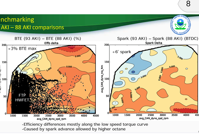

I'd love to see those charts if you've got em.
I have posted them every time this question gets answered incorrectly here. I on the other hand, I believe the data, the dyno, the science, and Dave Coleman.
The last time I posted this data, you saw and thanked me for it Ed
Yep I remember that being posted. I think end of the day the cost of premium fuel for what you get is not worth it. If you really want to go that route, get your CX-5 tuned for 91 or 93 octane (depending on your area).
Yes, it is not very cost efficient for what you get. But to say it has no effect as others suggested, would be incorrect.
