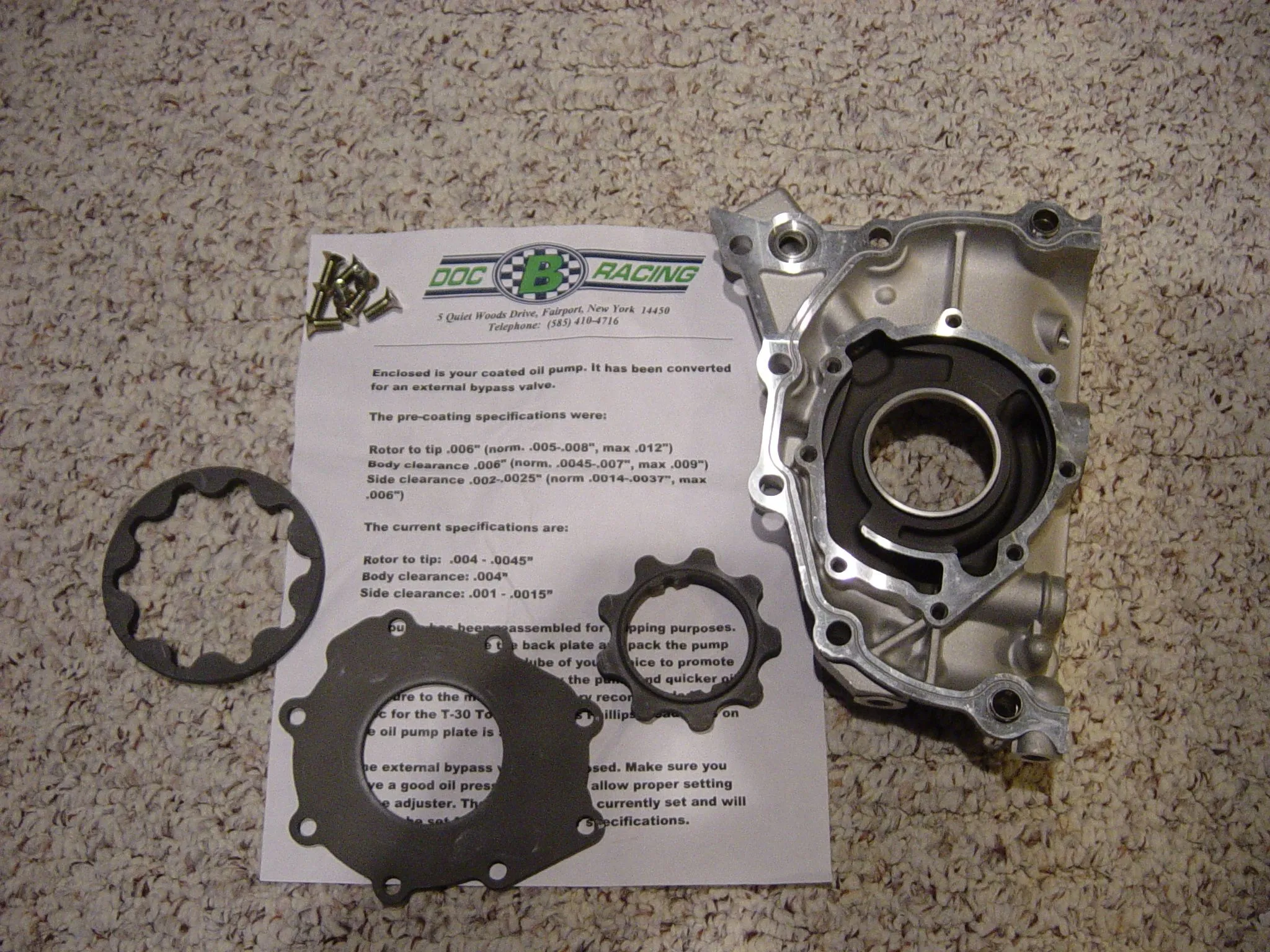

hi when i use my AC on my mazdaspeed the oil pressure drops to 0 PSI normally it is at 5-7 PSI with the AC off this is at Idle can anybody tell me if that is normal or if the oil pump needs changing. thanks
What gauge are you using to determine these oil pressures, the stock gauge in the dash or an aftermarket gauge?
i am using a prosport digital gauge
Is it an electric or mechanical gauge? If electric you might be having an electrical issue. If your oil pressure truely went to zero you would hear lost of noise coming from the valve cover! However, the normally low idle oil pressure you listed isn't great either....
it is electric and yes 1 or 2 of my lifters are keeping noise so would you suggest to change my oil pump and if so i saw top line have a replacement oil pump selling on ebay is that a good oil pump or is that a waste of time
http://cgi.ebay.com/ebaymotors/01-0...oryZ6778QQihZ027QQitemZ400016969622QQtcZphoto
If your oil pressure were at zero all your lifters would be making noise. That is not to say that a few lifters making noise is a good thing. The problem could be from several issues; needing an oil change, worn engine bearings, or a poor oil pump. I'd check out the system further before changing the pump though.
ok i changed the oil to see if the lifter noise would go away but it didnt i am now about to overhaul the engine because the engine is burning oil i have jus bought the full gasket set but i wanted to know if i can use the same oil pump or if i should change it because the low oil pressure may be because the engine is losing oil internally i havent had to put in oil recently but before i had to keep checking the oil level but since i changed the oil the level havent moved but i am going to go ahead and overhaul the engine do u think i should change the oil pump as well
HELL YES! Change that pump, and your water pump and anything else that is the LIFELINE of your engine. It is foolish to spend all that money on a rebuild and skimp on the most vital components. An oil pump is only $100. A seized engine will cost a whole lot more.

Besides the normal Upgraded oil pump and external PRV the list is:
20 feet AN 10 hose
7 AN10 straight fittings
1 AN10 90 degree fitting (bypass return to block)
Bung for Block Girdle
Oil Filter Block Adapter
Remote Filter Housing
2 Fittings for remote filter housing
2 Fittings for Oil Filter Block Adapter
Filter for remote housing

Are my rod bearings going or is the oil pump going?
Data;
Cold oil pressure - around 65 psi at 3k rpm
Hot oil pressure - never above 50 psi with a drop to about 40 psi at redline
When hot, the oil pressure drops a small amount (no more than 5psi) with any throttle application. Off throttle it goes back up.
Installed parts;
AWR oil pan
Brand new non ball bearing turbo with the stock Mazdaspeed oil feed line and no restrictor.
Block and pump have around 75k miles.
Thanks!

Hard to tell what is exactly the problem. More than likely with 75K miles it is a combination of both the bearings and the oil pump.
With 40 psi at redline, if your bearings aren't worn they soon will be!!
BTW, what weight oil are you using? Is it petroleum based or synthetic? How long has it been since your last oil change??
