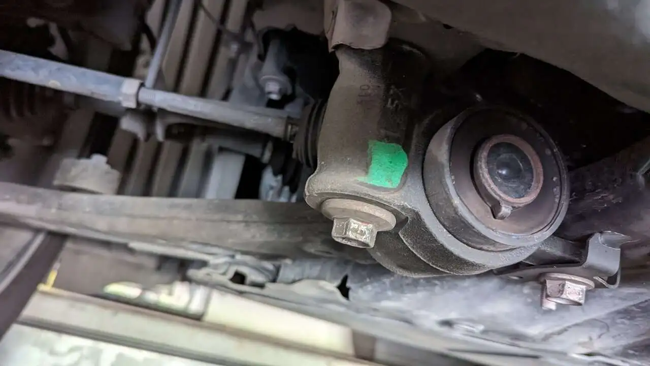

Do the diy urethane fix on those. I did it on my 16 cx5 when it split, about to do it to my 19 cx9 to make it drive better.
Takes like 5 mins to do and lasts a long time. Feels just like stock.

Hahah I looked at the cx9 bushing just now. Darn it's already all solid. Haha. I know the cx5 and Mazda 6 have the holes like in the pic because I did cx5
