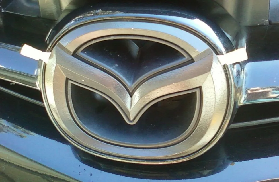

Front badge removal tip
06 LS MS6
07 BM GT (shell has been struck from the roll)
Be patient, be nice to the clips, they are incredibally delicate.
free one clip at a time, and keep it from reengaging with little helpers, ring terminals work well for this
pick a color you like the first time, so you don;t get good at removal, like me

I did mine for the first time a couple weeks ago. Since I read up on numerous threads prior to taking the emblem off, I felt pretty comfortable doing it. I took my time and used a little flathead screwdriver to help me. But for the most part, I used my fingers to unlatch the clips. All the clips stayed in tact. The rear was cake, too.
Pics of mine:
