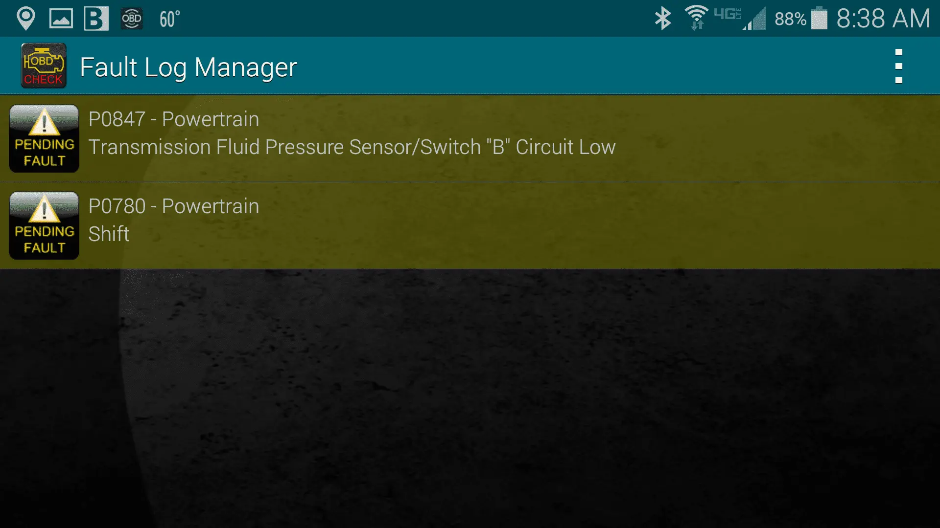

Happened to me today on the way to work. Was able to coast it into a turn lane to stop/restart the vehicle. I made it into work, taking it to a dealer this afternoon. It just stopped "pulling" and rev'ed the motor. Not a fun time.
Just so happen to have a blue tooth OBD-II module and torque pro on the S5. I'll try to upload a screen shot.
Codes were a P0847 and P0780. Also the TBS light came on. The tires did not check out as low with my gauge.

2015 CX-5 2.5L Skyactive AWD Grand Touring w/Tech Package. Bought new 5/2014. Slightly over 10K miles. VIN: JM3KE4DY7F0449xxx.
Update: At dealer now. There is a Mazda 6 here that they just had the parts shipped in from Canada to fix the same problem. Service Manager says there are no parts to fix in continental U.S. Service Manager is now on the phone with Mazda USA to figure out what to do with my CX-5.
Update2: No ETA on parts or fix. They didn't have anymore Mazda loaners so I am now driving around in a huge Ford F-150 4 door pickup. It's nice enough but I'm not looking forward to the MPG hit. Plus I haven't driven a full size in years and it's reminding me of why. It's like trying to park a small house.
Update3: Ok, they called me late today, claim it's fixed. I picked it up just before closing after returning the "loaner" F-150.
I could scan in the receipt (all covered under warranty) if someone really want's to see it. For those keeping score the fix as listed was for TSB #05-005/14 & replaced both valve body switches + various filters and fluids.
