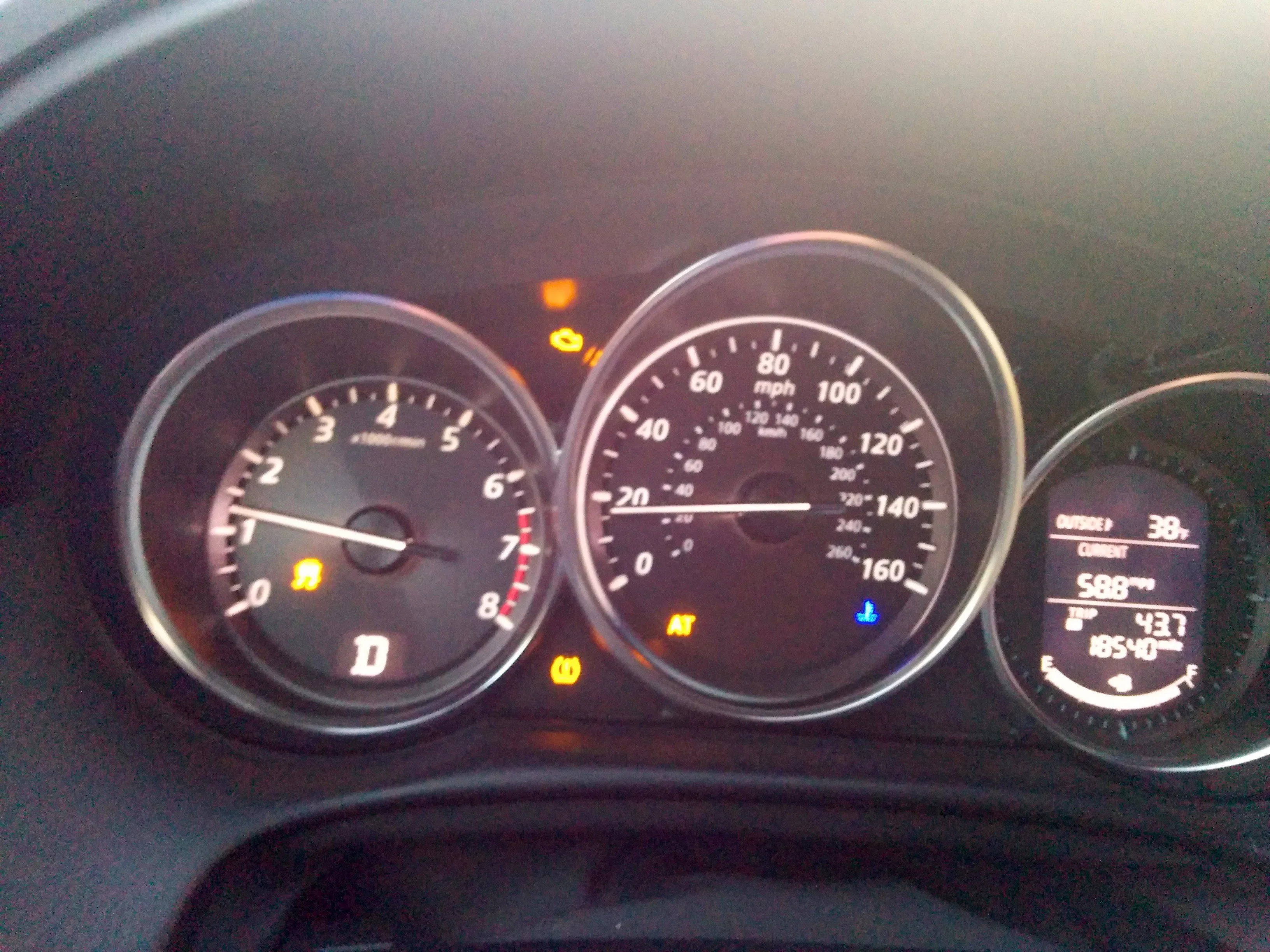

another CX-5 transmission valve body failure
Our CX-5 experienced the valve body failure last week with the same symptoms of power loss and console warning lights (pic attached) that have been reported previously in this thread. The vehicle was towed to a Mazda dealership and after reading the CEL codes (shift malfunction and shift time error) they determined that the valve body needed to be replaced. Fortunately, the replacement valve body arrived within a few days. The work order states replacement of valve body (PEX2-21-C00), a clamp (FZ01-19-967), and Type F transmission fluid (0000-FZ-113E-01). In addition to replacing parts they also preformed a relearn procedure afterwards. A technician indicated that the limited valve body failures they've seen have been within the first 5000 miles, and it was somewhat surprising that it happened after 18K miles. Nonetheless, it was all covered under warranty and they provided me a loaner vehicle.
I reported the incident to MazdaUSA. They documented in detail the conditions at the time of the failure and were in contact with the dealer on the status of the repair. My wife (who is the main driver of this vehicle) was almost rear ended at the time of the failure. She was at a stop light and after she started accelerating, she lost power after several seconds. There were no brake lights to indicate she was slowing down and the vehicle behind her barely avoided rear ending her. Definitely a serious safety issue. The MazdaUSA rep indicated that the review team is taking these reports seriously and will determine if anything needs to be done to proactively fix this issue once they have a better idea of how prevalent the issue is and whether it is associated with a specific production run. Rep was very informative due to having a CX-5 as well and talked a lot about new model shakedown issues.
If you have experienced this problem, please report it to MazdaUSA directly as well as the NHSTB.

I forgot to mention in my previous post that another Mazda technician informed me that there are two possible fixes to this problem. One possible fix is a software update and a second fix is the replacement of the valve body. In my case, (based on the CEL codes) the fix was to replace the valve body. (They didn't indicate that a software update was attempted/needed for my vehicle.)
