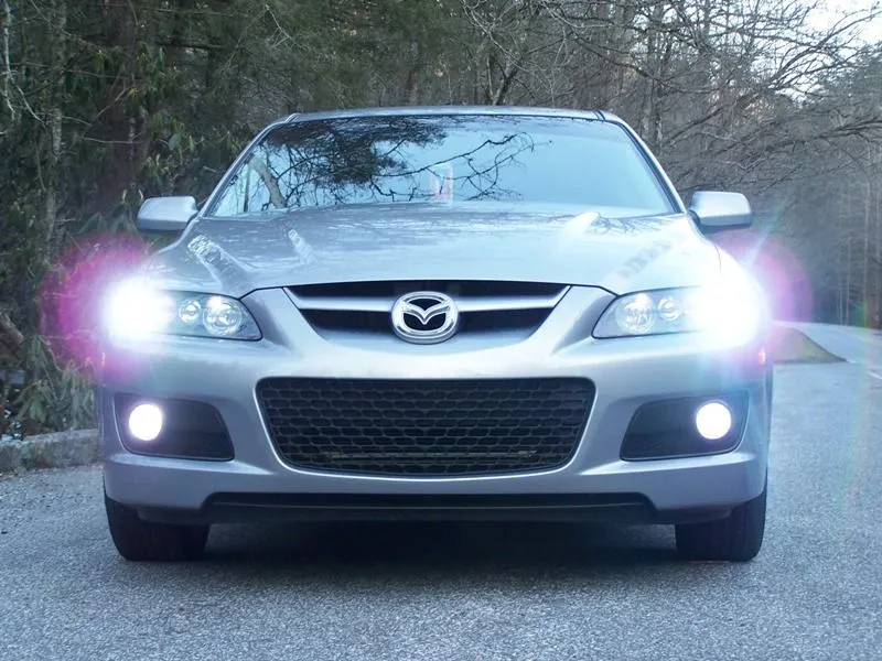

Before the install
After the install
And that is it for the install. If you have any questions please let me know and I will do my best to answer them.
