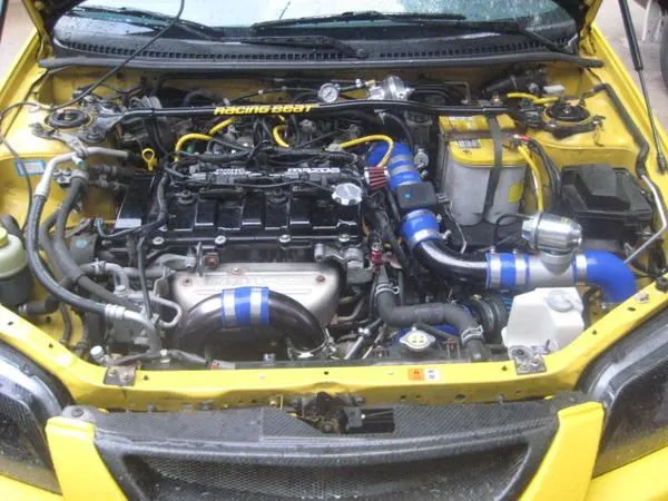

Pictures...
Ok, the engine is a high performance rebuild that has about 9k miles on. (and this is all hearsay from the original owner, again I have no documentation whatsoever) The body has about 66k on it. I replaced the spark plugs when I got it, and they're clean as a whistle. (that's one of the few things I do know how to do) Here's a couple of pics of the engine bay...you can't see from the pictures but the coolant system is a mess, I laughed when I saw the fans zip tied to the chassis, which makes me question the sanity of the person doing the mods.

You definitely have a vacuum leak. Your vacuum should be 18 at the lowest, 20-24 optimal.
As far as the intake and FMIC setup goes, it's totally legit. I have mine setup the exact same way, and have zero issues with it. What he did was the MAF relocation, which moves the MAF from the intake to the cold pipe of the FMIC but people usually do that so they can install a BOV before the MAF that will vent to atmosphere, instead of recirculating like the stock BPV does. And from the looks of it, the previous owner simply unplugged the other end of the BPV and is allowing it to vent to atm instead.. not sure how effective that is.
I would probably start by locating the vacuum leak first and that will probably fix a lot of your issues. You have a pretty significant leak if your vacuum is reading 10-15 in Hg, and vacuum leaks are pretty much the downfall of our cars. Check ALL the vacuum lines going to and from the intake manifold. Make sure they're not cracked and that they're on securely. Also, I don't see the IAT sensor anywhere.. it should be in the intake pipe. It comes off the MAF wiring harness, so just follow it and see where it leads to. It's a small anchor looking sensor that goes into a rubber grommet located on the intake pipe.
EDIT: I've attached a picture of my setup. It's essentially the same thing. Short ram intake with just a filter and aluminum pipe going to the turbo (the IAT sensor is also in the intake), and a BOV right before the MAF on the cold pipe (you have the stock BPV instead), and just a small breather filter on the valve cover instead of the tube going to the intake. My car runs fine, and my vacuum at idle is 18 in Hg. I also have a leak.. but as massive as yours.

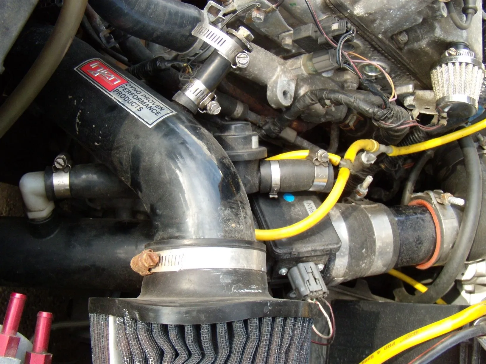

Thanks for the help guys, I'll get the vacuum leak checked and see what it does for me. You can't see it from the pictures, but I just went out and checked and the far end of the BPV connects into the lower part of the CAI. (at least I think that's what the BPV is, it's the little round metal thing with the black arrow on it in the 2nd picture, correct?)
What's wrong with the air filter? (aside from being ugly and a little dinged up in spots) The picture may make it look dirty but it's actually quite clean, I got one of those K&N filter cleaning kits and made sure it wasn't choked up or anything.

Ok, the BPV is hooked up, I've edited the photo so you can see what I'm seeing.
1. The bottom part of the BPV, it's connected to the FMIC.
2. The top part of the BPV, the arrow is pointing to the back of the engine bay (I'm assuming that this is correct, air would flow from the intercooler, to whatever it is in the back (what is that part called anyway?) The black elbow goes down and then connects to...
3. The underside of the CAI which has a 6 in or so metal tube which has a hose connecting to the BPV. My understanding would be that the BPV would be venting air into the CAI if I follow the arrows and understand BPV operation correctly.
The air system is a closed circuit. There's no venting to atmosphere via the BPV as it currently stands. I'd like to get the HKS SSQV BOV, would I remove the BPV and simply put the BOV in it's place? I'd like to have this stuff done professionally, but I haven't been able to find a place in West Michigan that does custom auto tuning or anything like that.

yes, the way you have it setup is correct. Since your MAF is already relocated to the cold pipe, you could take the BPV off and replace it with an HKS.. just cap off the pipe leading to the CAI.
good performance or not, what I would do is start by putting the MAF and BPV setup back to what it was supposed to be... MAF at the filter, and BPV doing what it's supposed to do.... get rid of the ghetto caps and the stupid breather filter... run the hose back to the intake... THEN when it's working right, start screwing it up then
^+1 on that advice.
That was gonna be my advice as well. Just put it back to stock setup and see how it works. If the car doesn't run right under stock conditions, then it for sure won't run right otherwise.
I'd also say if you make changes like that, be sure to reset the ECU by disconnecting the battery (negative terminal) and pressing down the brake for a few seconds and then reconnecting.
It might not make a difference, but it can't hurt.
To clarify a bit, if you want to put the MAFS back to it's "stock" location, all you need to do is locate the MAFS right between the intake and the filter--you'll need a 2.75" coupler to couple the MAFS to the intake, and then the filter just clamps onto the other end of the MAFS (that's my current setup).
As for the gap where the MAFS is currently located, just get a piece of 2.75" aluminum tubing the same length as the MAFS.
Also, yeah, sorry about the BPV thing... from the first pic, it looked like the other end of the BPV was just open to the atmosphere.
It does look like it's open.. that's what I assumed as well. I dunno how it's hooked up to recirculate back to the intake, but it doesn't look very secure. That's probably the source of your vacuum leak right there..
