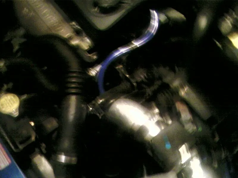

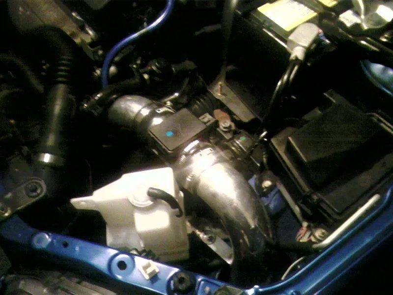

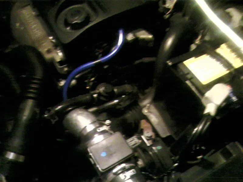

ok.. then.. thats what im gonna have to do!! does anyone have a link or pic of the vac line diagram??? or can take some pics or something.. because i wanna get this solved soon.. or imma go crazy!!!!!!!!

i have some now.. theyre from my cell.. (its all i got...) kinda crappy.. but here.. u cant really tell n e thing.. lol
