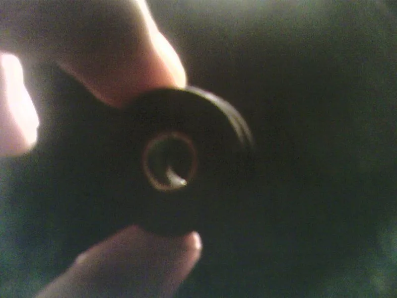

when i installed the intake it happened to be very late and stuff and i guess i just forgot to put the stock grommet thing around my air temp sensor.. and i believe thats causing an air leak!! DUHH!!!...... but my ? is.. would this actually cause the rpms to drop???
i need help fast...
and also.. is the thing in the attached pic the stock grommet???

no.. i didnt get them replaced.. but we have checked them all really good and theres no leak!! im thinking that its the hole in the intake where the grommet thing is mising
Umm.... well put it in man! ...and replace your vac lines no matter if you tested them or not... the stock lines SUCK bad and will end up giving you problems. $3 or $4 in tubing...
